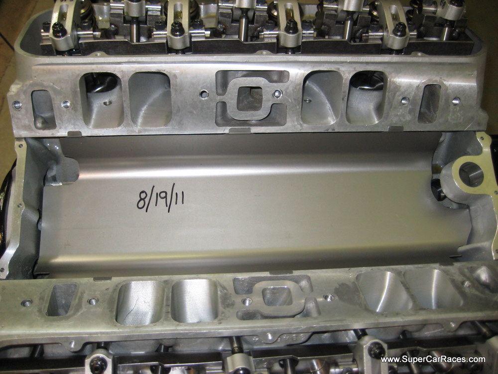

Hopefully to stay !!!! Going in today...
Ryan

I like the valley pan, ...purchased, or fabricated at home?
 Post subject: Re: ITS BACK.........ZL1
PostPosted: Sat Aug 20, 2011 7:29 pm
Posts: 242
Ted, stock gm from l88 and zl1. Chevy performance parts listted it up until a few years ago. I think there discontinued. This one is a repo i purchased from Heartbeat City. If i recall the originals from Gm perf parts came painted black..
