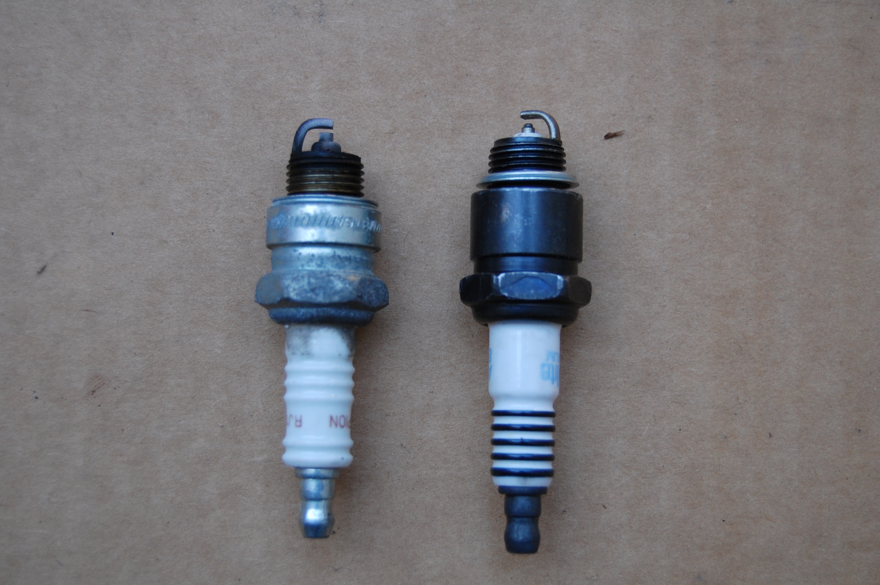

I replaced the champion spark plugs on my 69 6pak bee with autolite 85 platinum plugs this weekend and the bee did not like them! I noticed a hesitation right when I started it up and every time after that. The biggest thing I noticed is that I could smell the fuel from the back of my car, in fact, it stunk up my house real bad (the drive way sits right in front of the house and I have an attached garage). Also, I noticed that when I turned the car off, it would shake a bit, some people call it "dieseling."
So, I'm going back with the champion plugs that were on there before. I just thought I'd share my experience. I also included a picture of the 2 plugs for comparison.
Juan
DSC_0053.JPG [1.48 MiB]
Downloaded 235 times
 Post subject: Re: SPARK PLUGS PLEASE!
PostPosted: Mon Apr 12, 2010 9:08 pm
Sounds like you have a cracked plug or two. I also heard that they just started making Autolites in China. May be a sign to go to NGK's in the street cars. Juan check the plug ceramic area. Also what ignition are you running. FYI I put a set in the 71 RR I ran this past weekend, I had no issues.
