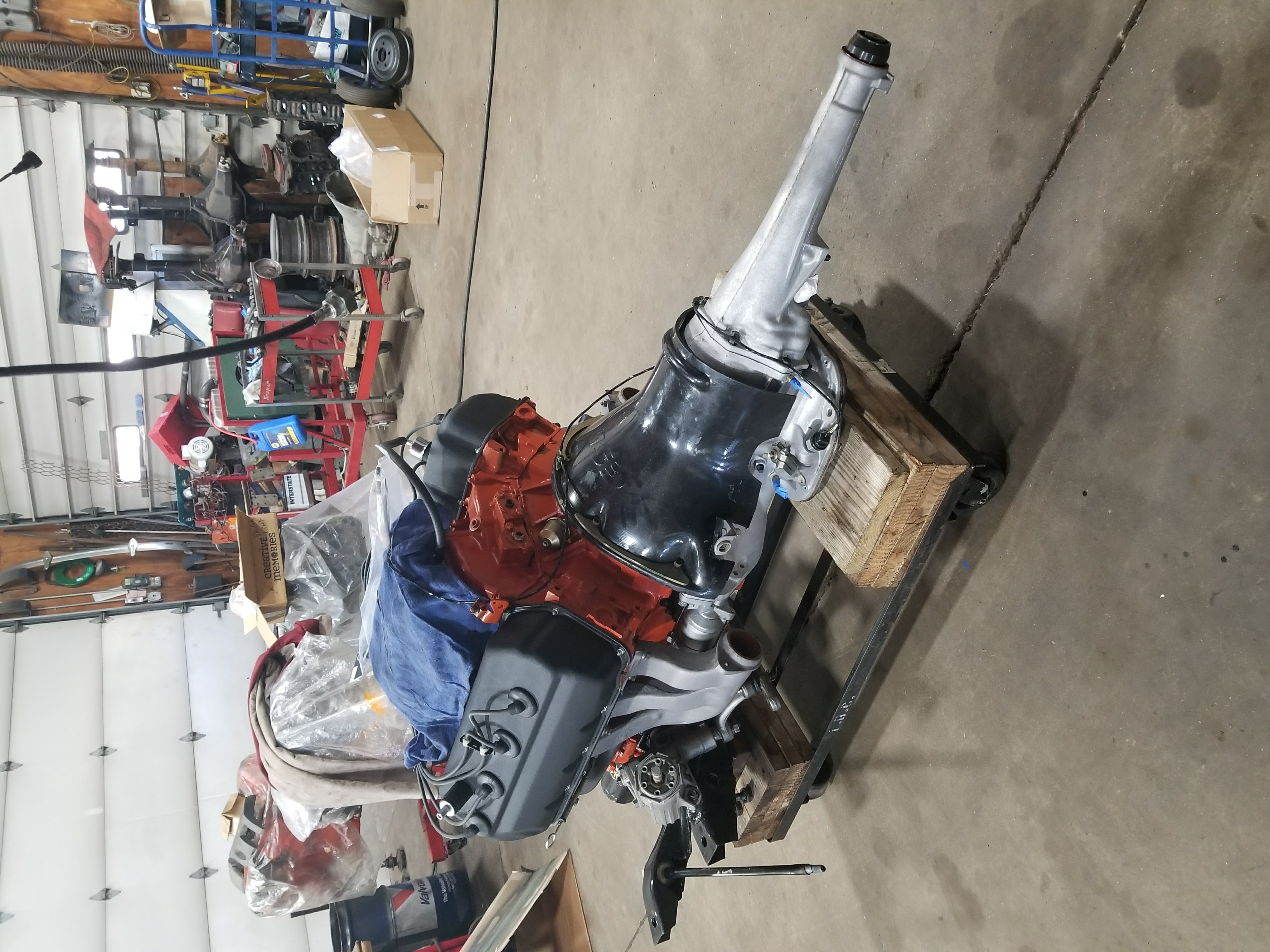

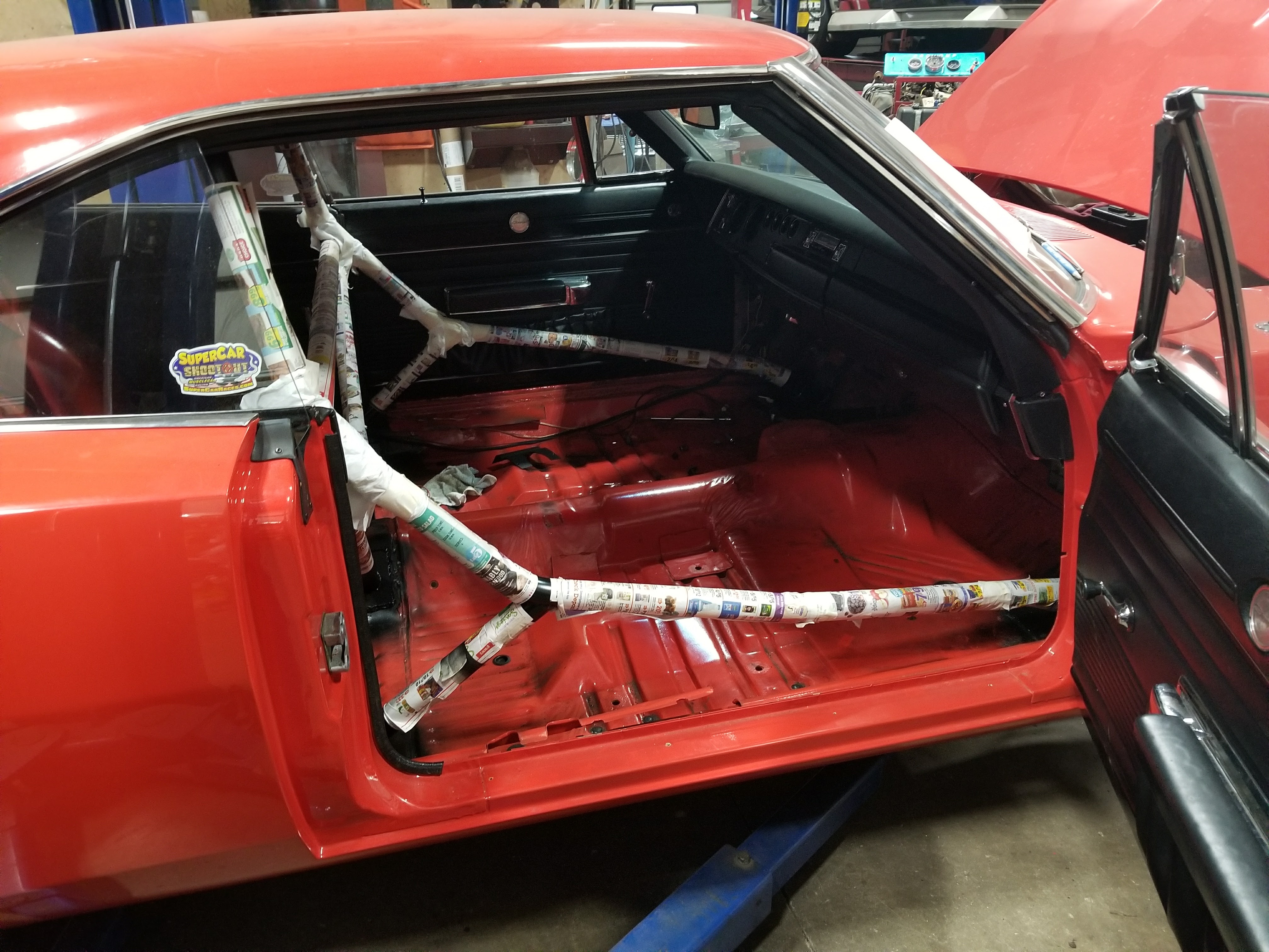

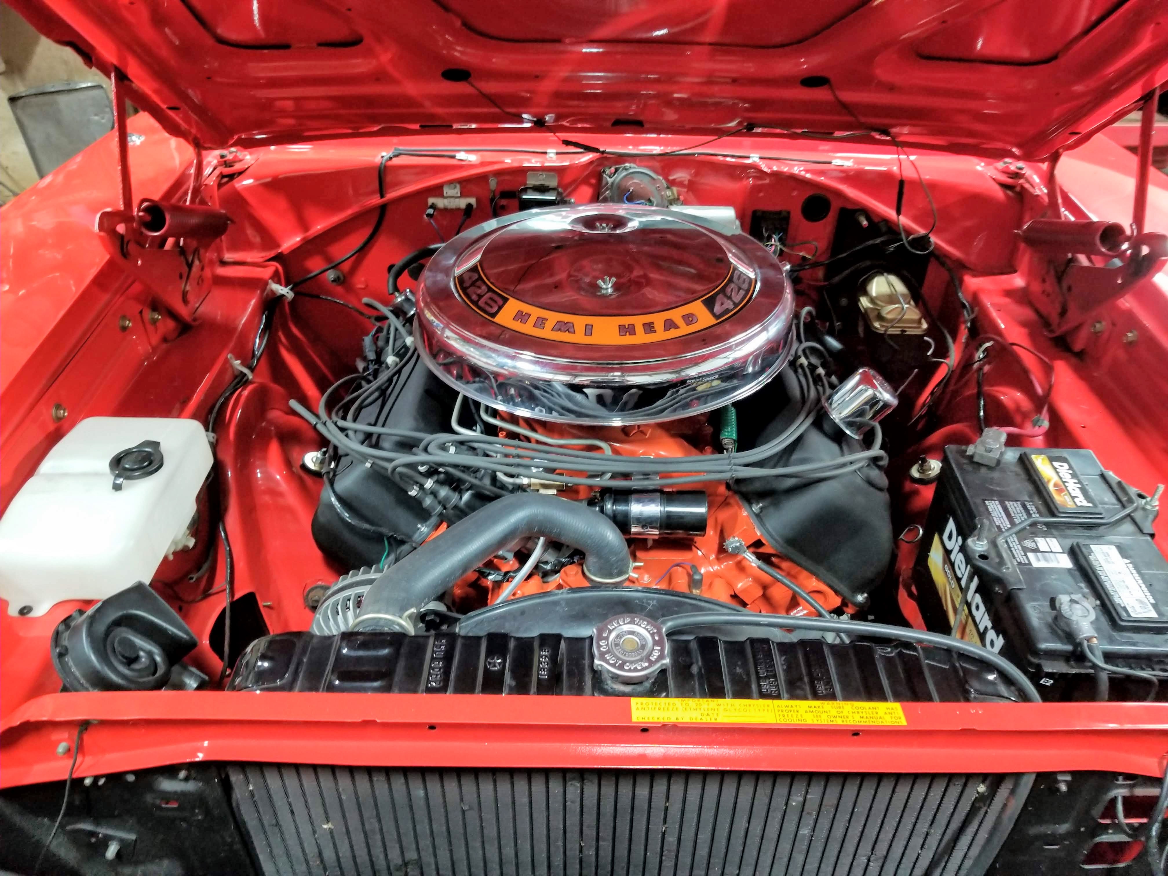

This thread is coming maybe a year or two late but I'm going to document the build and the year of struggles with TNT's Charger. This all started shortly after My dad won the Supercar Championship. Tom approached us with an Idea to build a Factory Appearing Hemi to race in Supercar and hopefully It would be able to run with Ted and Greg. So we took delivery of His 1969 Charger 500 440 4spd car. It currently had a Hemi in it but a tame street motor not a power plant that could potentially run with the rat motors. So it was removed along with the 4 speed in favor of a Stronger Hemi and an automatic.Image Image
So this is where the fun or frustration really started what ever you want to call it. We made a call to Dave Dudek to get a recipe for a 600hp motor. So he promptly got back to us and advised us the build although we tool some of his advice we weren't looking for 840hp we wanted a much more modest 600-650. Modern cylinder head did the port work on the cast iron Hemi heads. I called our cam guy at Cam-Motions to get a discuss grinding a solid roller cam not a 50 mm but a stock cam core. The recipe also included a set of roller rockers from Ray Barton racing we opted for the spray bar options as we did'nt want to bush the lifter bores. As far as the bottom end goes we used an eagle crank and rods but had trouble finding the right pistons. We had a sample from Dave but they were quite exotic but we had no blocks that would fit a .030 overbore. So after sending the piston to a few manufacturers and being made promises to no avail. We finally opted for a set of CP Pistons that our friend Greg Hundt had got for us. We were on the home stretch we thought. Until the pistons arrived and almost knocked the head right off the block. Fortunately they were great to deal with and rushed us a proper made set to get around 13 to 1 compression.

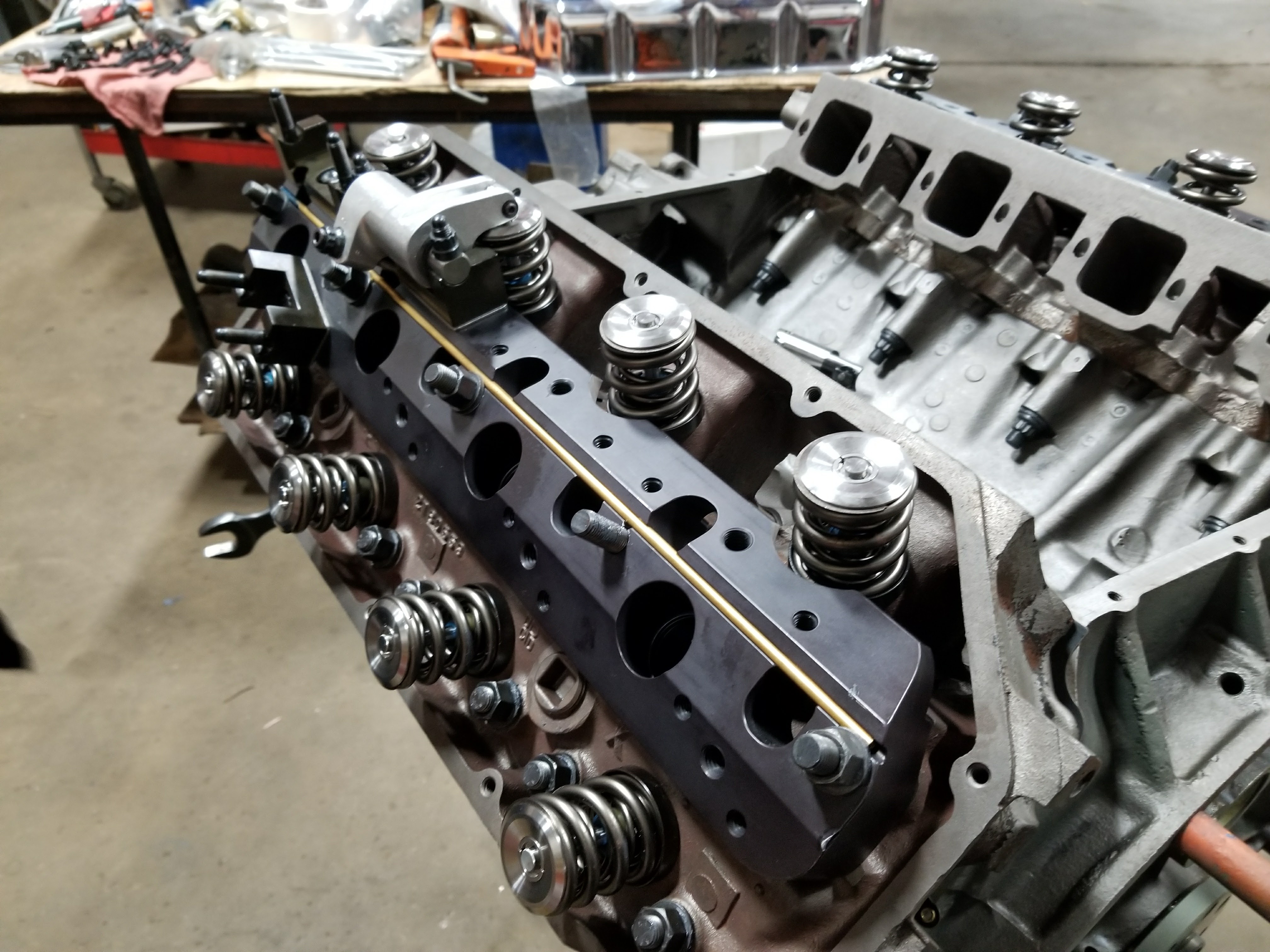

Some pictures of the engine being assembled.
20171204_131459.jpg [1.51 MiB]
Downloaded 393 times
20171117_095529.jpg [1.2 MiB]
Downloaded 396 times
20171117_084328.jpg [1.33 MiB]
Downloaded 411 times

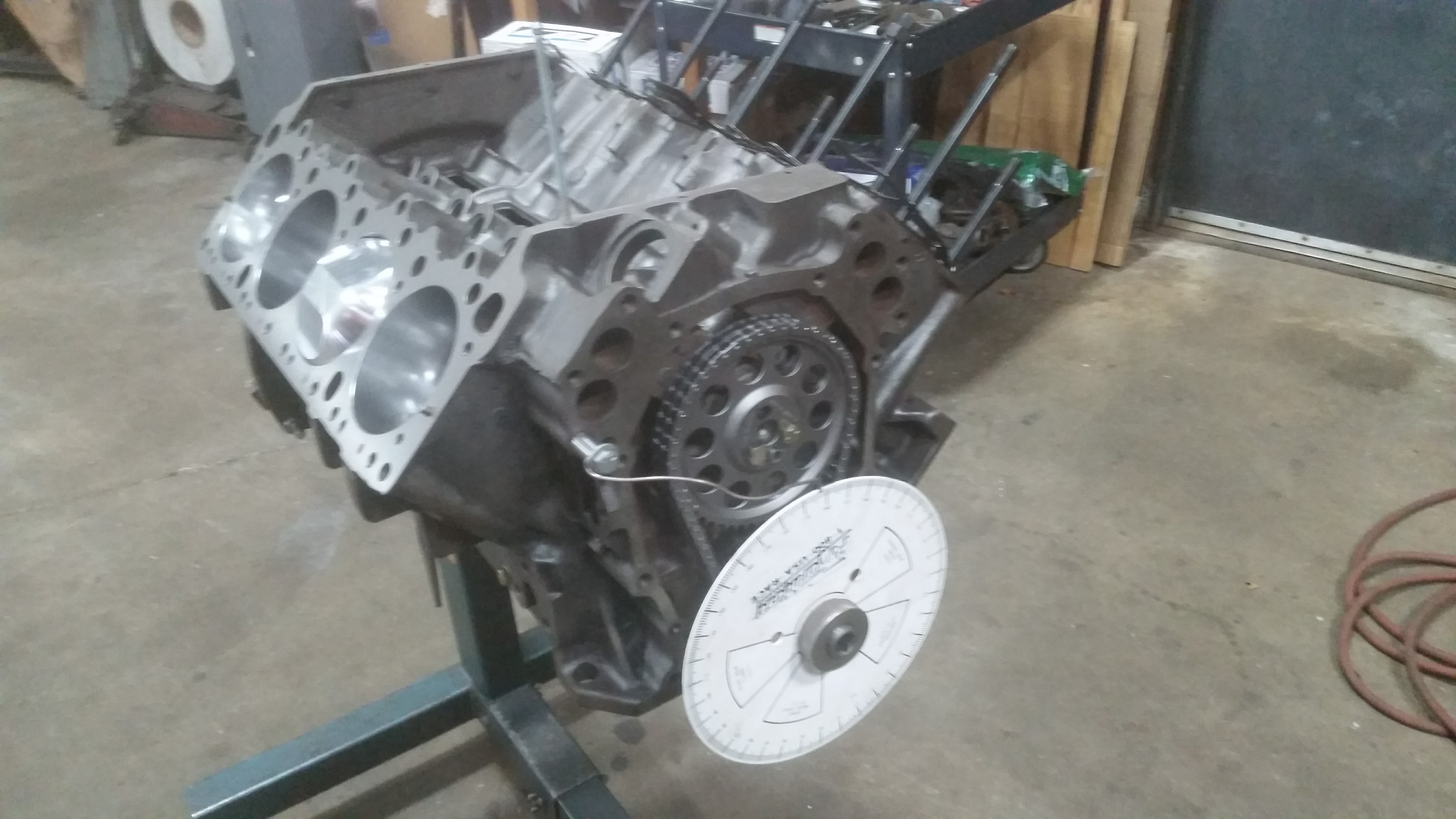

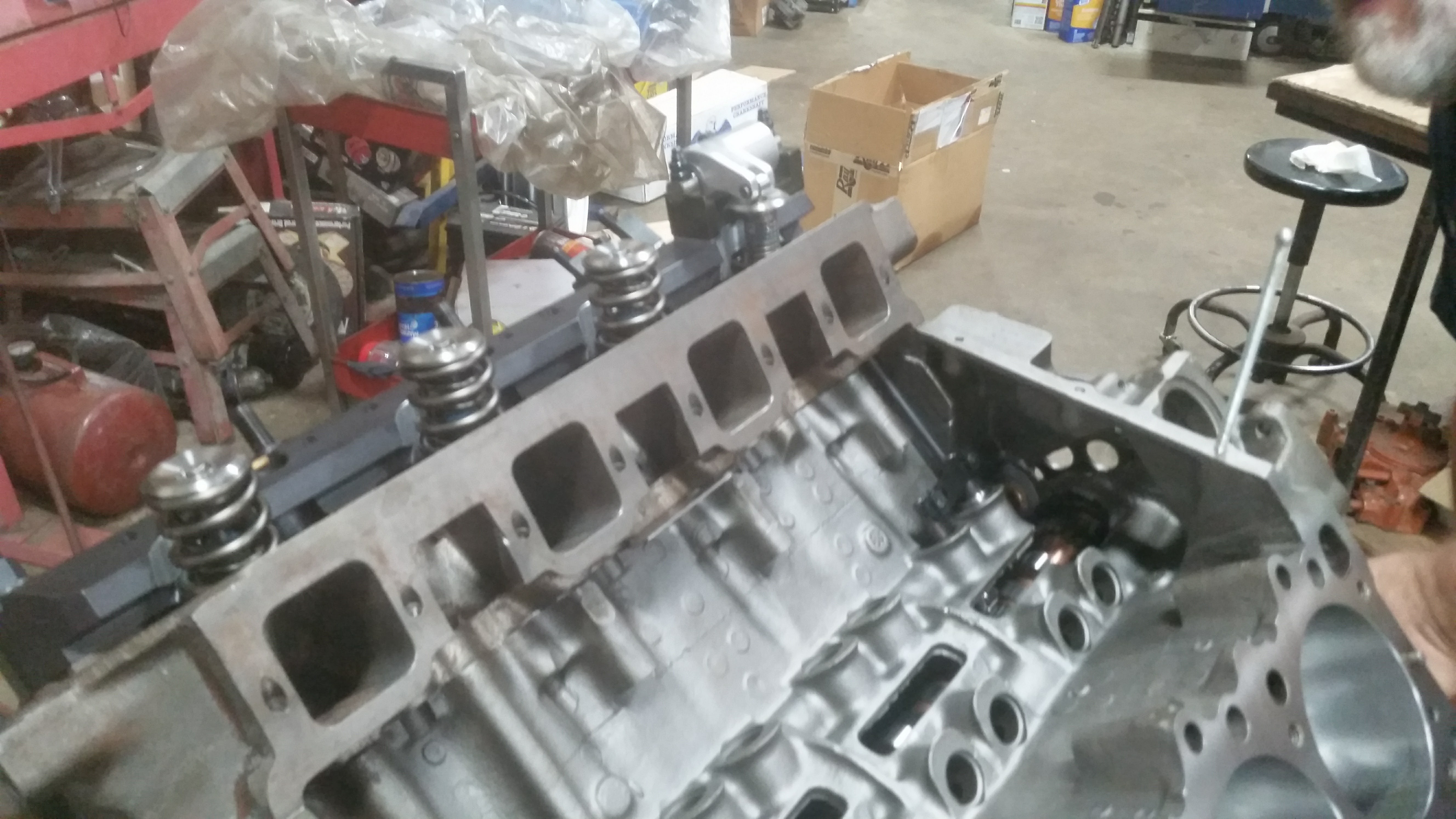

more pictures
I have a full album of the car on Facebook along with Videos of The Dyno Pull
https://www.facebook.com/media/set/?set ... 181a027e3b
20171205_150603.jpg [1.94 MiB]
Downloaded 410 times
20180404_141600.jpg [1.23 MiB]
Downloaded 426 times
20180306_131039.jpg [1.44 MiB]
Downloaded 420 times
