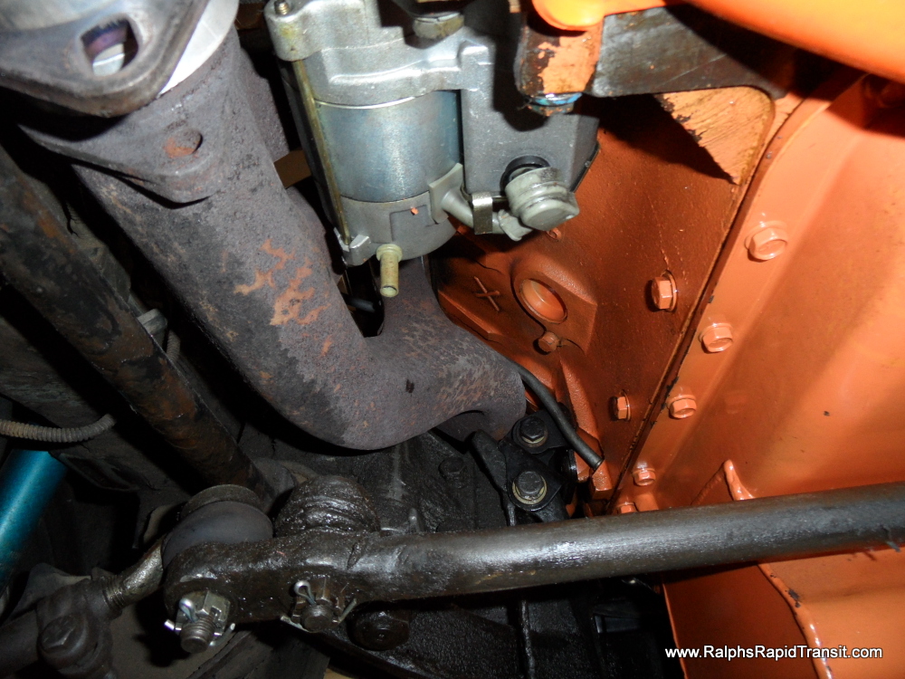

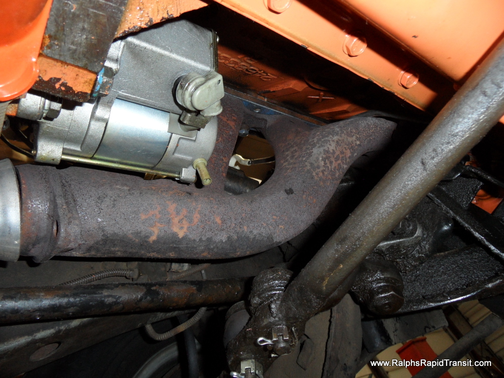

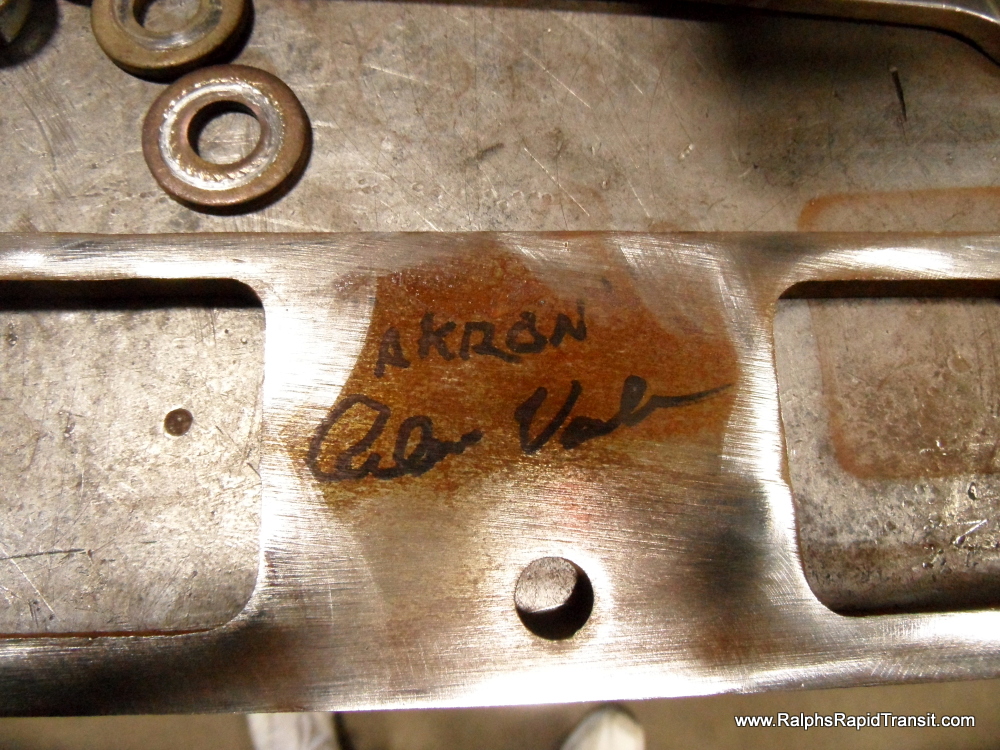

PostPosted: Thu Mar 14, 2013 9:48 am

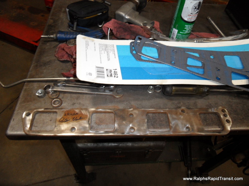

When I assembled this build I used and 11' bell housing and had issues with clearence of the starter to the exhaust manfold. The fix was to use an exhaust header flange as a spacer. I Bought a set of them from :bow Akron Arlen Vanke 8 yrs ago. He even signed them for me!

Clearence issue fixed!

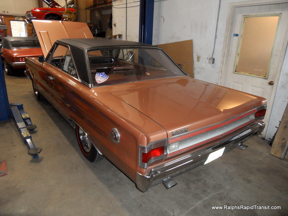

A couple of small issues left to do and back on the road. For now the GTX's racing career will be on hold. Cruising will be in this GTX's future very soon.

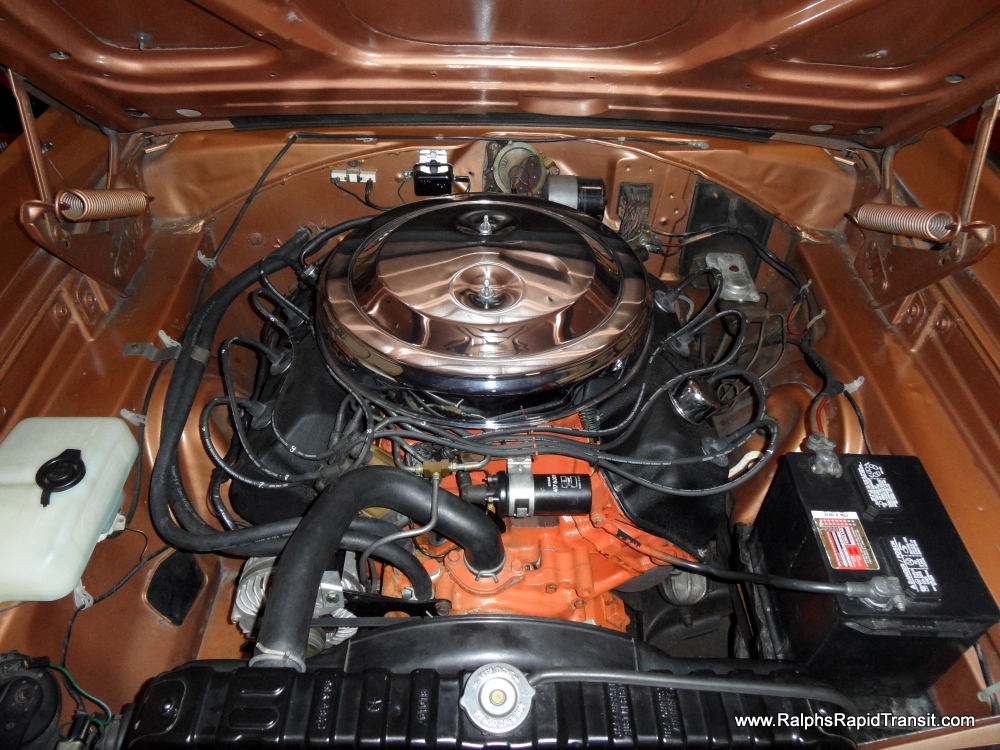

Picked up te GTX yesterday.

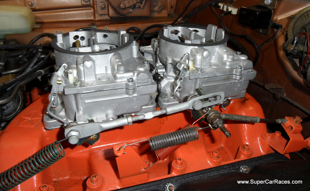

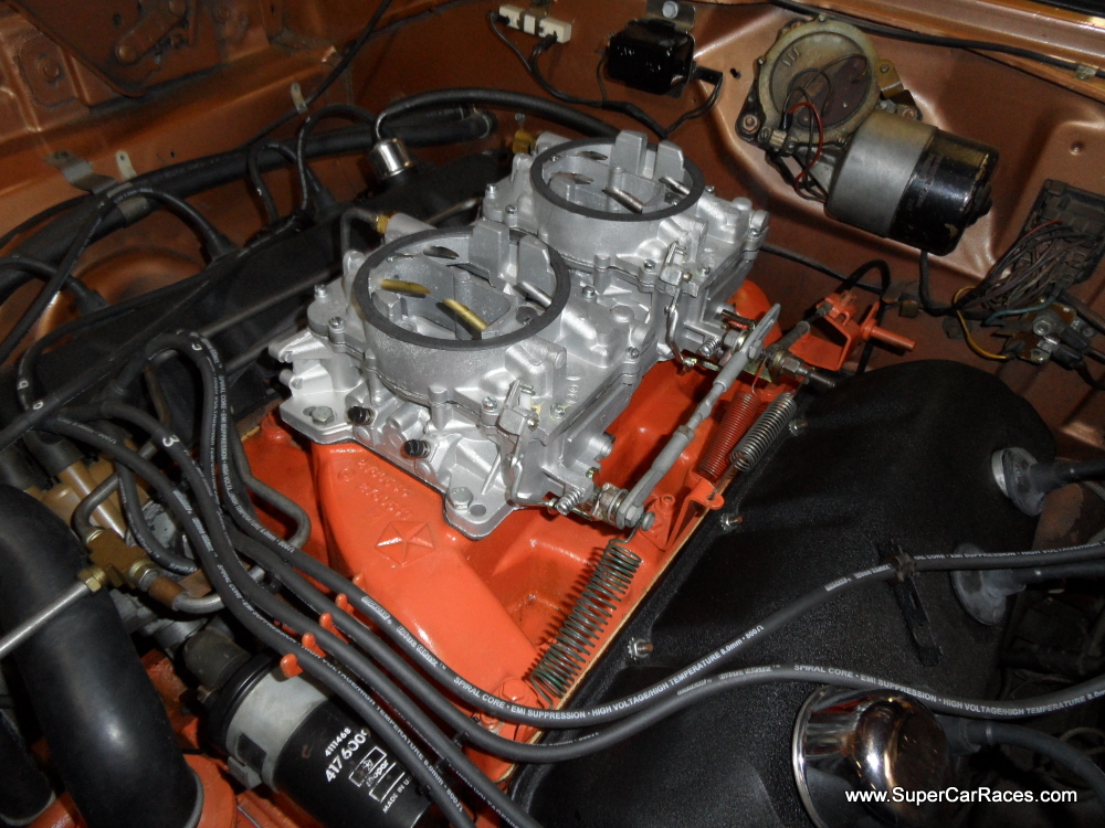

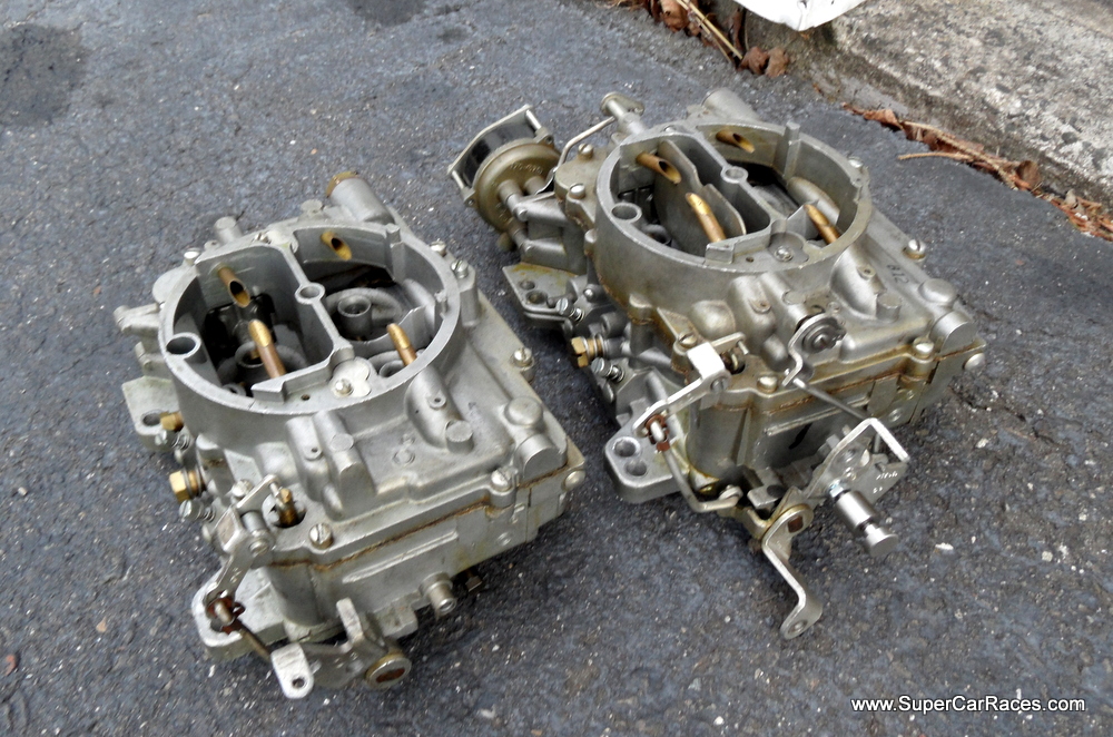

Test carbs are off and the new set of Dick Katters are on. Tonight wire in the Electronis Ignition, Fix the E-brake issue, Remove and Detail the Hurst wheels and Tires, more detailing and cleaning, then Church on Sunday :bow .
