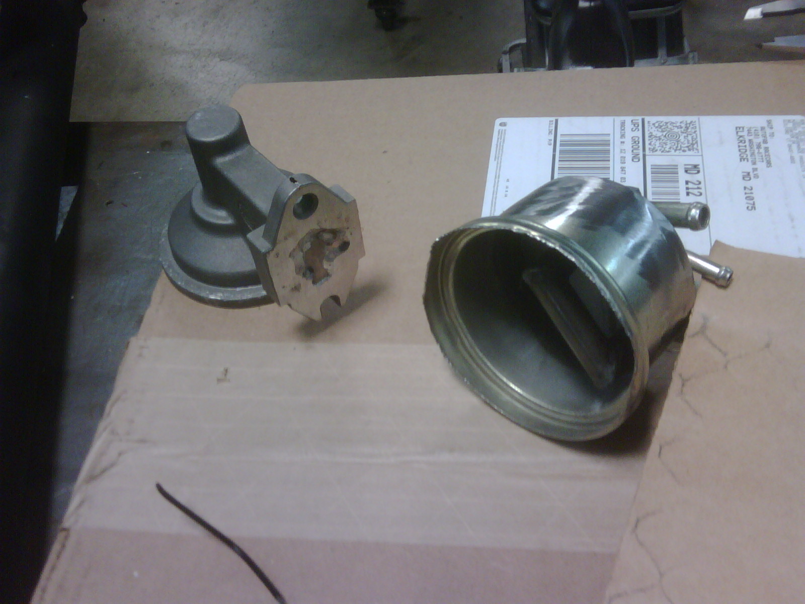

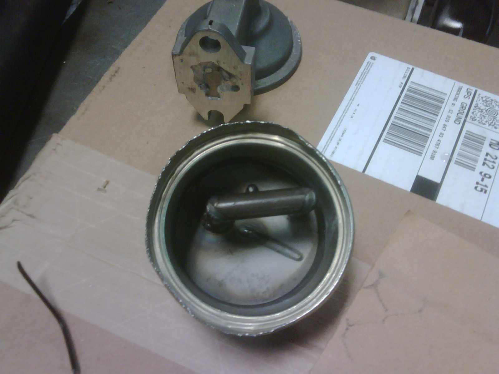

After all the advice. I took apart a pump to see how it worked. The needed welding was over my head so I took it to AutoFab Racecars down the street. Rob, the owner, worked it and this is what it looked like before reassembly.

Looks Good :aok
 Post subject: Re: Dummy GM mechanical fuel pump
PostPosted: Wed Sep 19, 2012 11:07 am
Very cool, I would love to know details about how to get it apart without destroying it. And likewise about how to put it back together without it looking like it has been taken apart. Not legal for my car, but maybe one day I'll be able to afford to put together a S.A. car.
PostPosted: Wed Sep 19, 2012 4:53 pm
Posts: 82
I can't speak for all pumps but in the case of the Olds fuel pump I just gently worked the "crimped" upper assembly free of the cast lower assembly. I did this by "uncrimping" the upper assembly with a small prying tool. You can see the evidence of this as you look at the photo. To put it back together it just needs to be re-crimped.
Scott

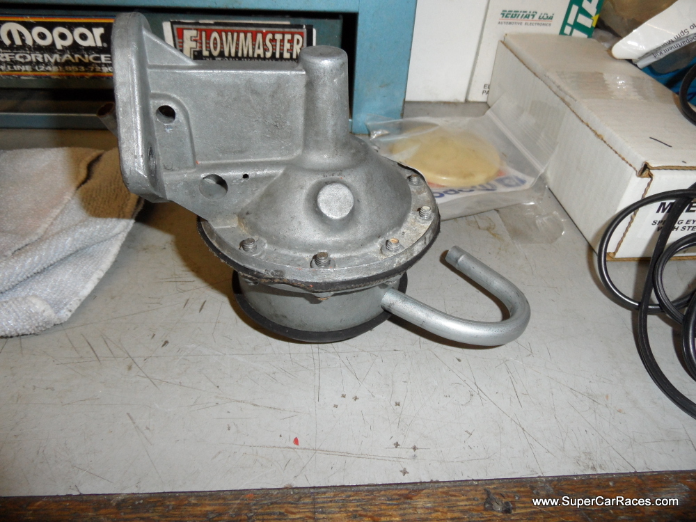

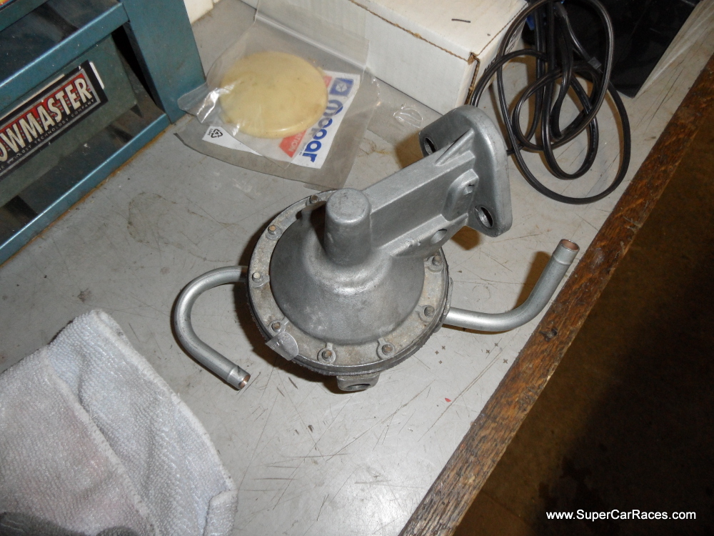

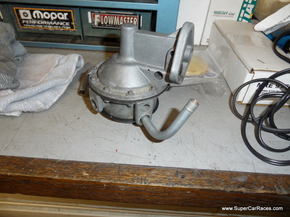

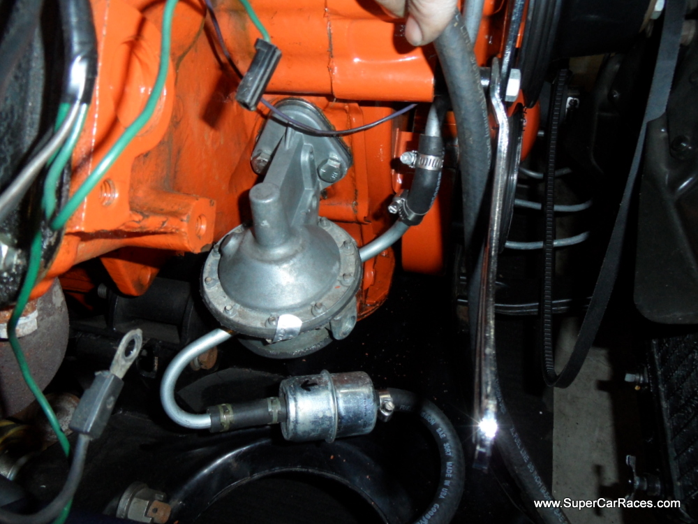

For the Chrysler guys looking to do the same, I just completed mine for the HP2.
