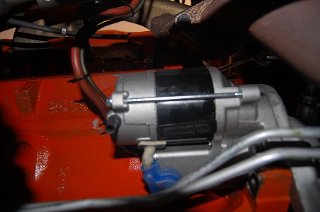

I went with a mini starter from a 1991 Dodge Dakota-bought from Autozone for $65-after I returned the core. I had to grind/file down the body of the mini starter a little to get the bolts to line up. It works well and it's much lighter and easier to put in the car. I doubt I'll ever go back to the original type starter.
Thanks a bunch for the tip Ralph!

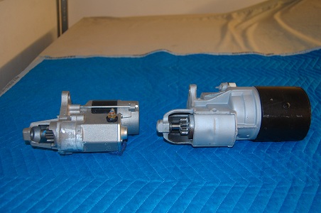

2a

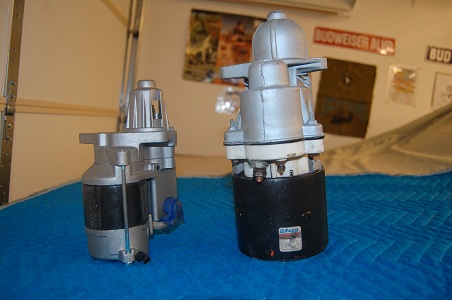

bolted in the car.
