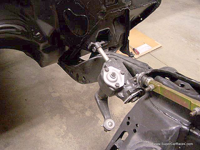

It's all in the detail

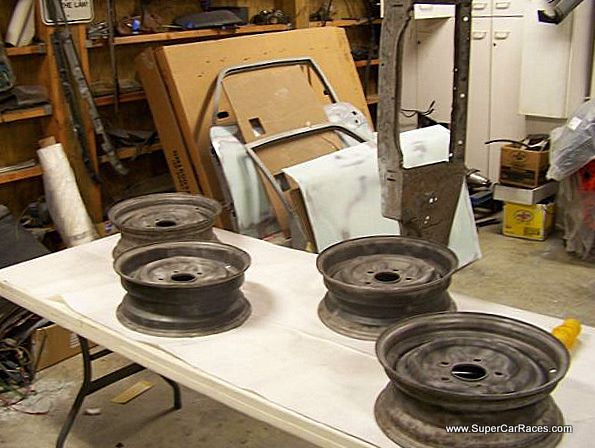

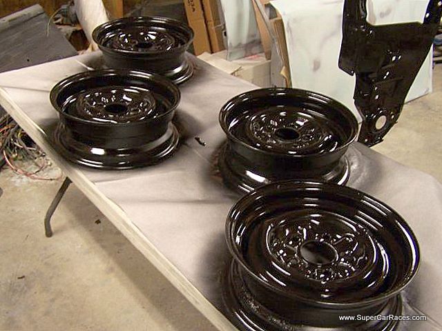

We painted the black on the wheels, Color will be added later to the faces.

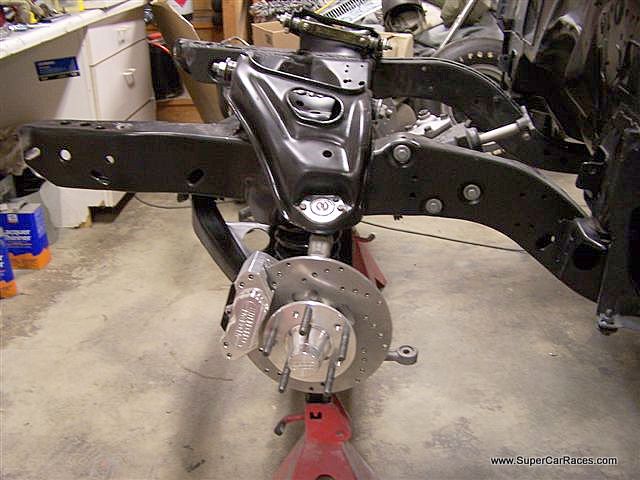

Front brakes and components

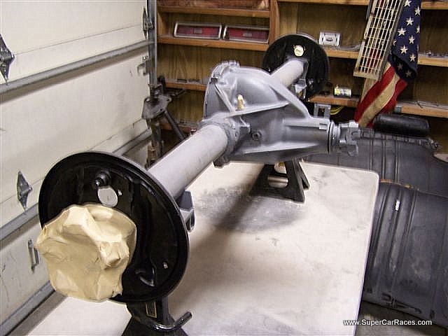

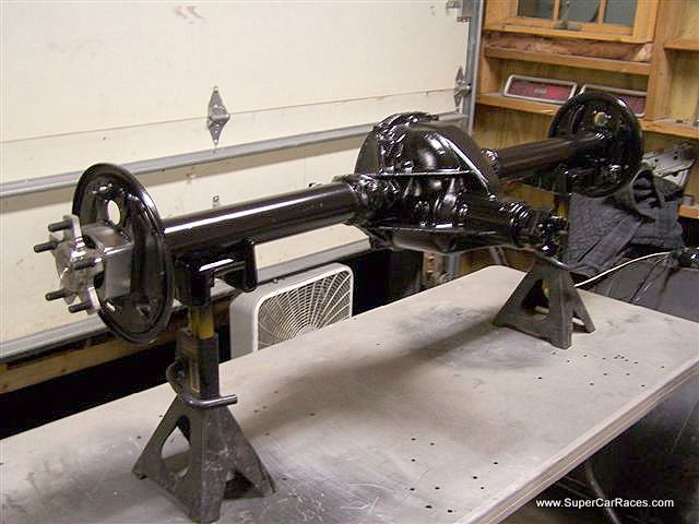

PostPosted: Sun Feb 21, 2010 9:28 pm

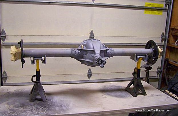

if you notice, this rear is set up for multi leaf springs (perches) and will not be a mono leaf car, those are only for lower horsepower cars!
internally we have 3.73 gears bolted to a lightweight spool, c-clip eliminators, and gun drilled, fluted, lightweight axels!
MMMM....GOOD STUFF! :-D ....cant weight to bolt it in!

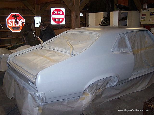

body is coming along nicely and should be in primer soon!
the roll bar is half way there and should be done by the end of the week :-D

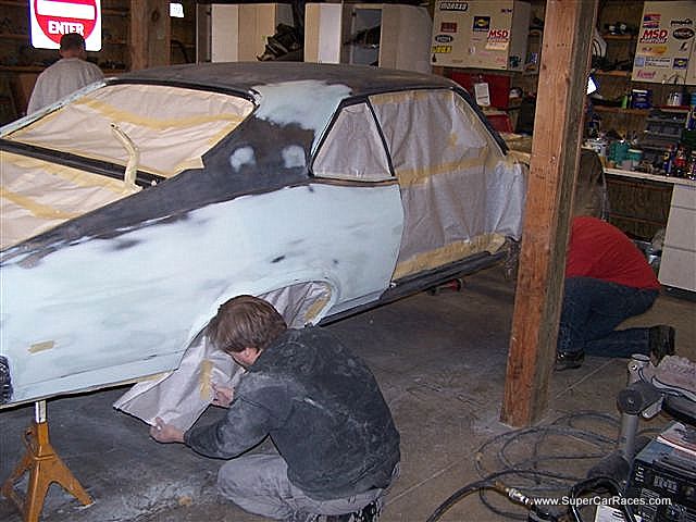

PostPosted: Sun Feb 28, 2010 11:49 pm

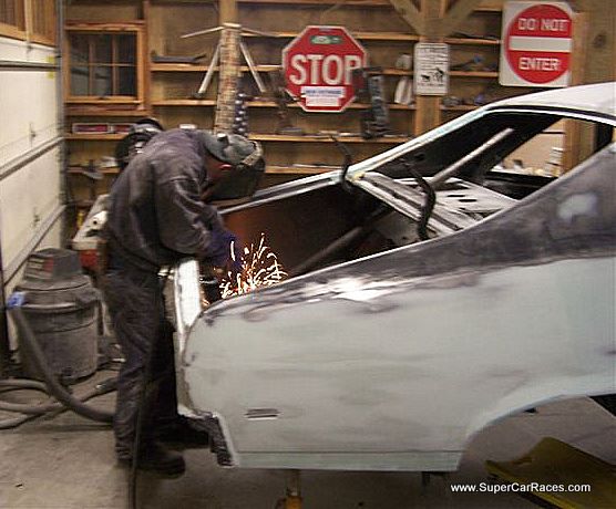

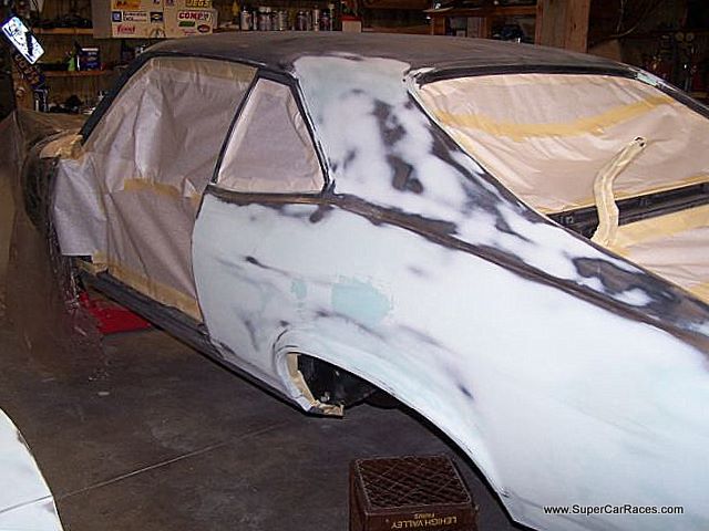

Body work, roll bar, primer. Next, sanding and then color....

PostPosted: Tue Mar 02, 2010 12:11 am
thanks kwhizz,
as a nova guy you will notice, as i decided to build a 69 L89, i closed in the marker light openings, and tail light openings, to accept the correct lights!
i like the 68-9 tail lights better anyway
we fabricated the roll bar to run parallel with the sail panels to be more pleasing to the eye, and the hoop is in the shadow of the door pillar when standing left or right of front.
being a big guy, the side bars are a little high on the hoop, so as to catch me in the right place as nhra rules require.......so a little more is seen than i would have liked...but....so it goes!

Ted, I like how you taped up the car as to hide all you have done inside. :wink: :aok
PostPosted: Tue Mar 02, 2010 8:13 am
yeah, i didnt want anyone to see the woofers, and tweeters :lol: :lol:
Or the hydraulics :wink:
