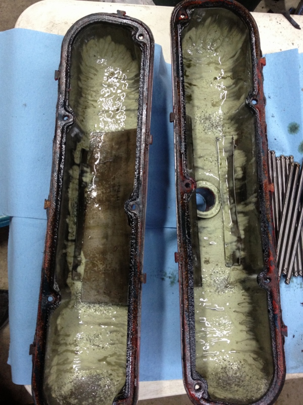

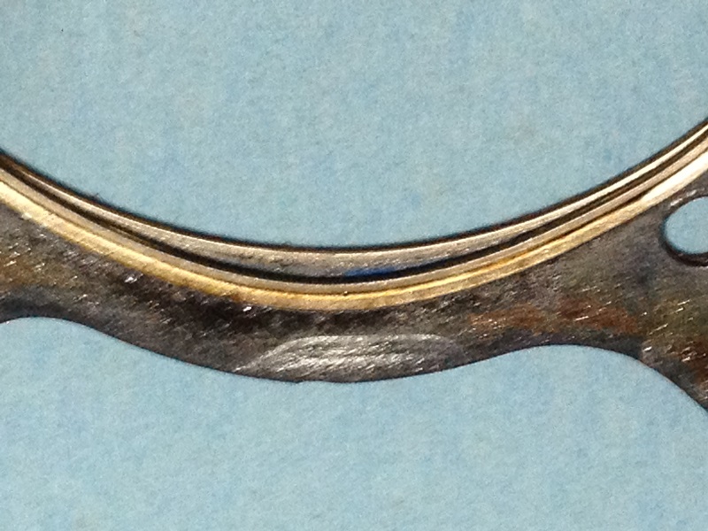

Found out why the car was off. popped the head gasket. very minor leak. parts should be here Thursday. head studs. the gaskets on top of each other. pushed it towards the valley
PostPosted: Wed May 27, 2015 10:45 pm
I think the gasket started to fail after I got it warm when the lower radiator hose froze while towing it. Squished the gasket.

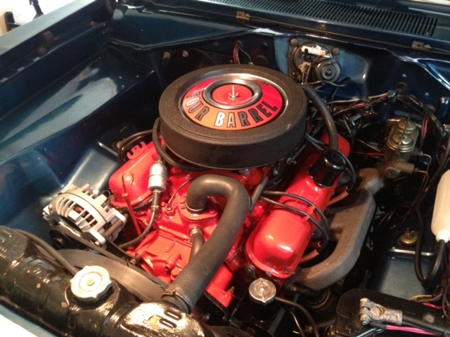

All back togethet, washed and waxed and ready to go! :hungry
PostPosted: Mon Jun 01, 2015 8:53 pm
Was able to fix the paint on the valve covers.
