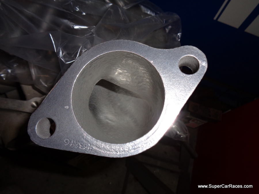

The first process on SuperCar Manifolds is to Polish the inner surfaces. This is done with ceramic media.

After the surface is polished to a chrome like finish the inner surface is High Temp Coated and then baked.

The end result

The average price to have a set of Exhaust Manifolds coated for SuperCars is $350.00. The process is special to SuperCars.

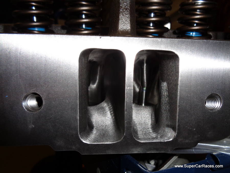

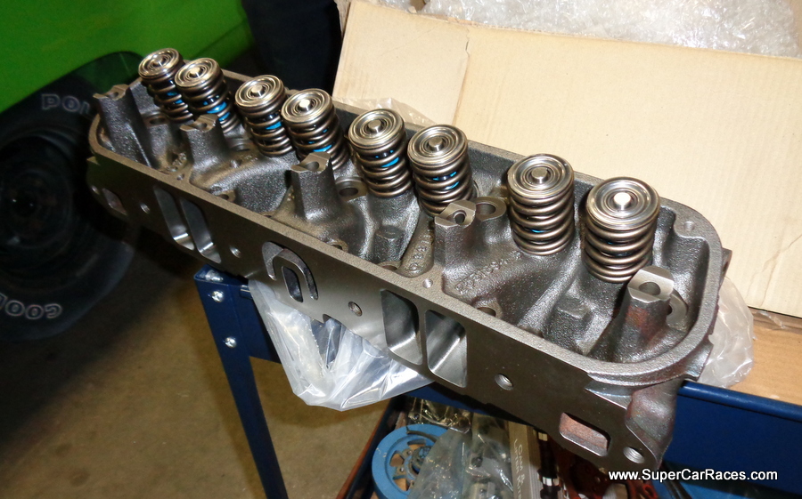

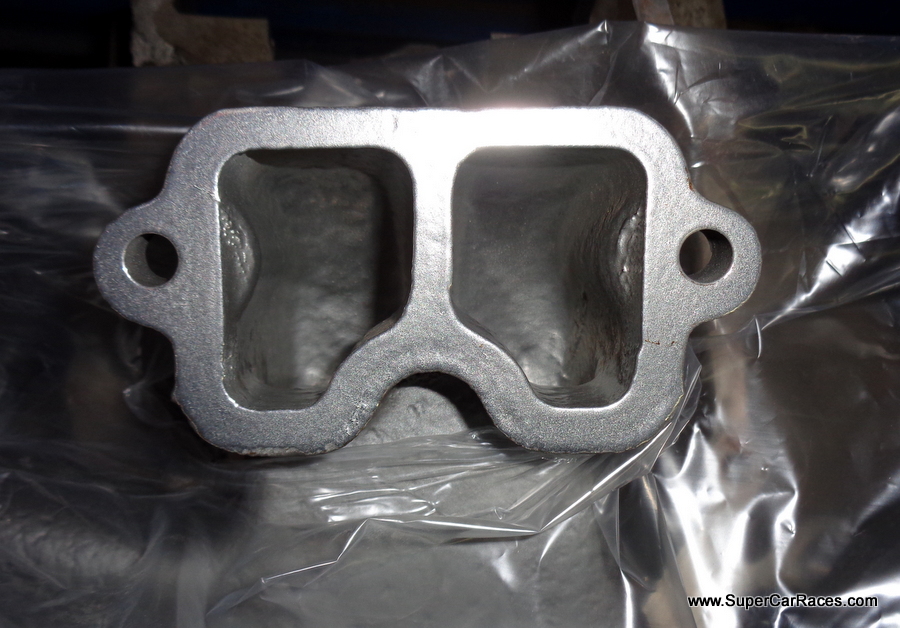

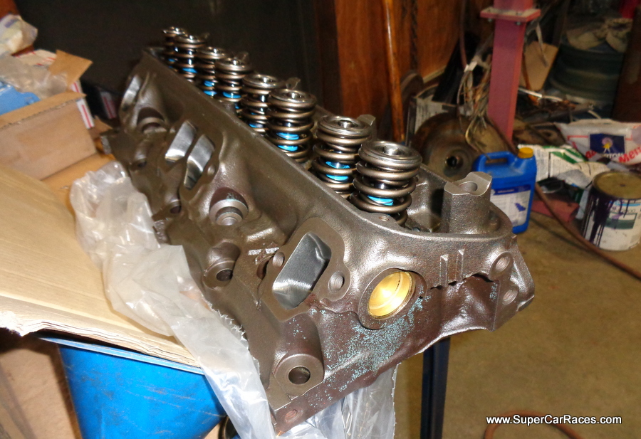

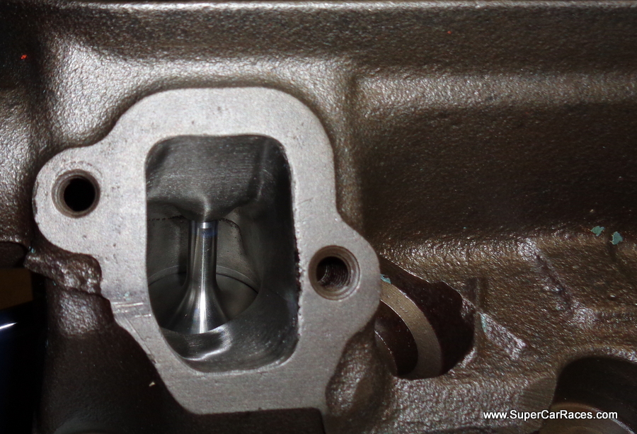

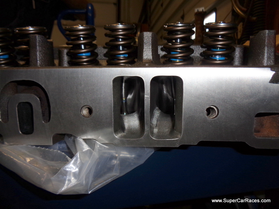

The Heads have arrived! Porter Racing has come thru once again. Check out the goods. :pop

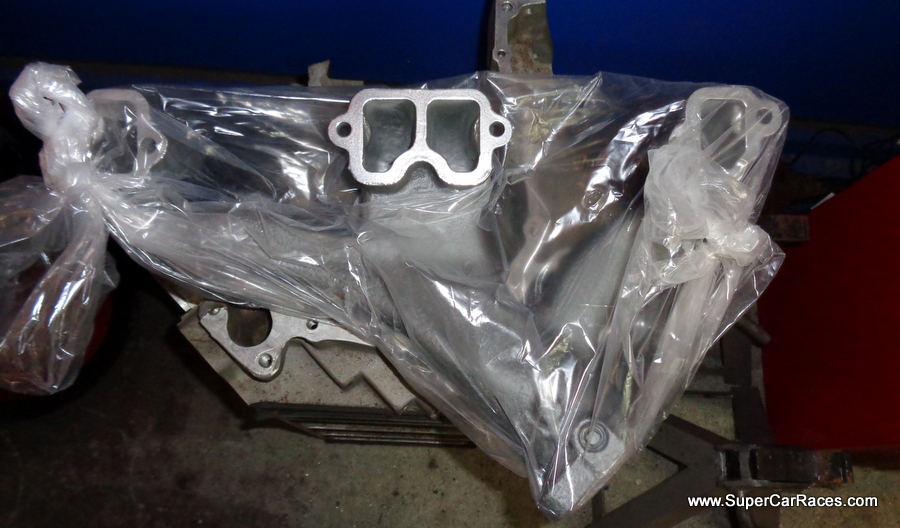

PostPosted: Fri Mar 27, 2015 11:30 am

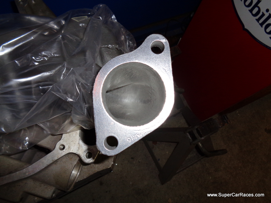

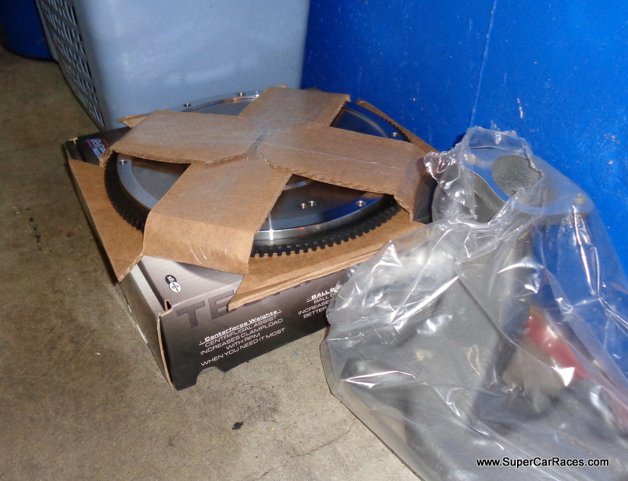

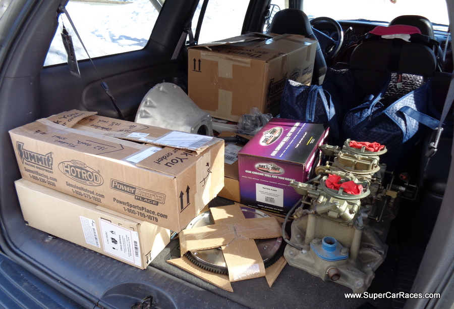

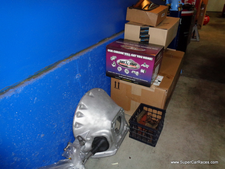

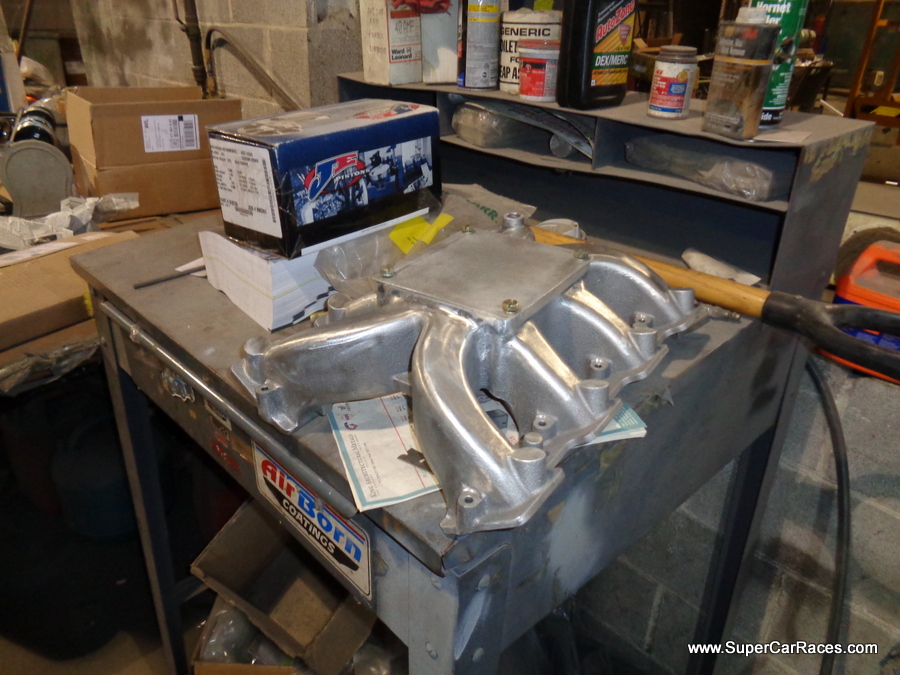

Loaded up more of the go fast parts and bringing them to Auto Services Of Old Saybrook.

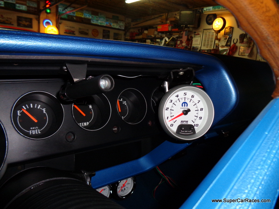

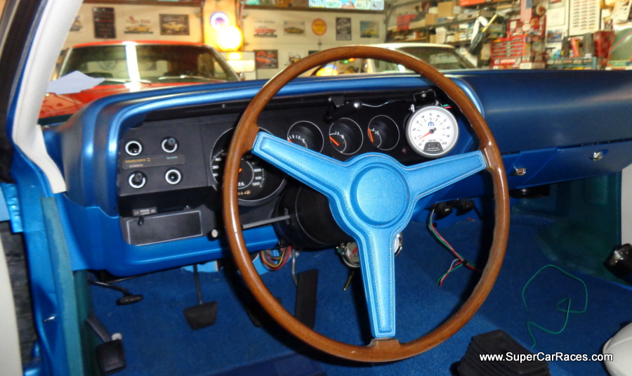

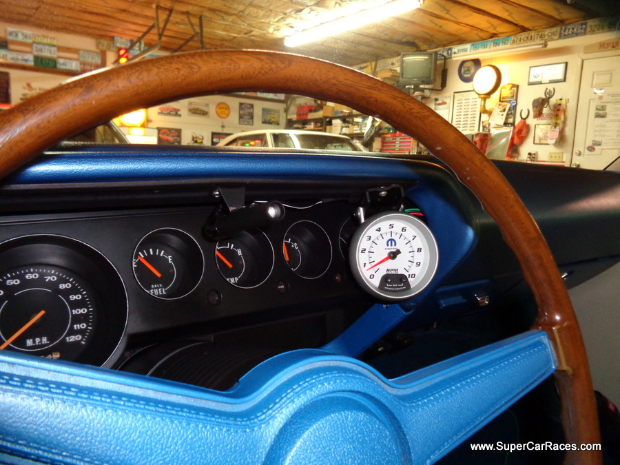

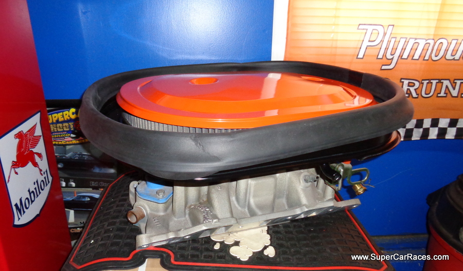

Attention!! We finally have a tach that meets all requirements! :cheers Looks good :aok The Right Color Face :-D The Right Size :bow Relocatable Shift Light :blah Check it out :pop

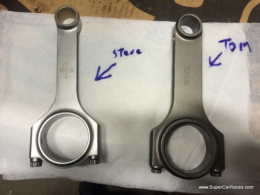

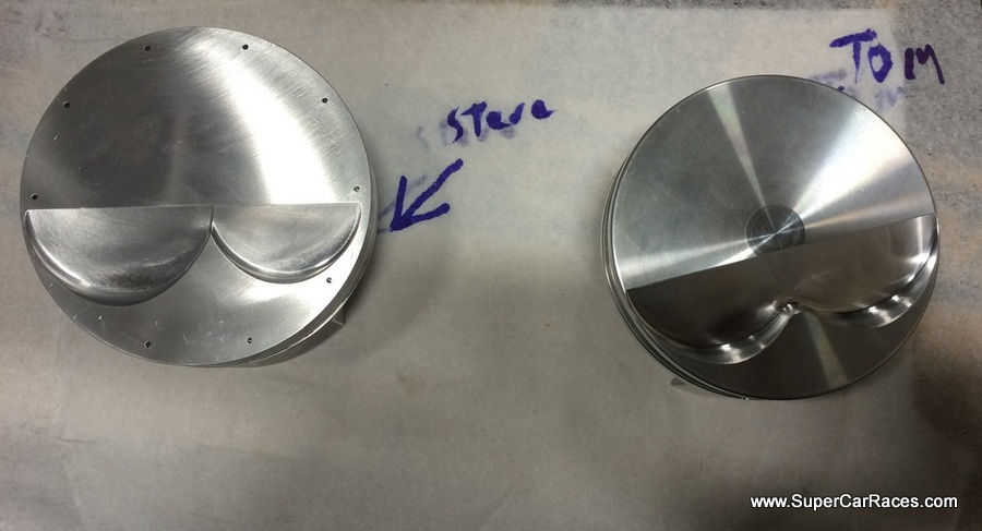

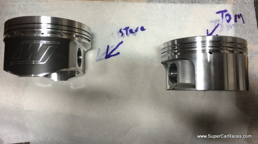

The Rotating assembly is completed and ready to go. Enjoy the pics. I thought you may want to see the difference between a 416 Assembly (Tom) and a 444 Assembly (Steve)

Why is there holes in those Pistons?
 Post subject: Re: Steve’s 1970 AAR Cuda build 340+6BBL 4 Spd.
PostPosted: Fri Apr 03, 2015 12:18 pm
Gas ports. To help seal low tension rings by using cylinder pressure to push the rings against the cylinder wall. If i remember correctly. :pop
