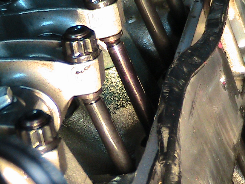

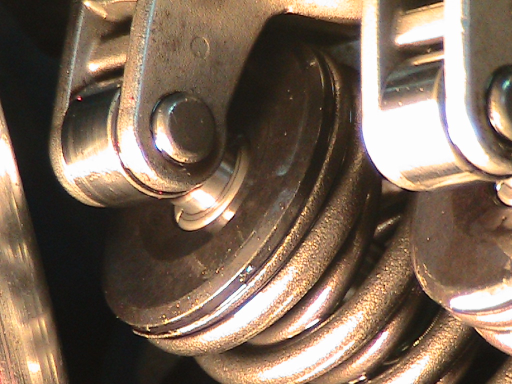

PostPosted: Mon Jun 07, 2010 6:20 pm
To determine the correct length you should look at how far the adjuster is out of the rocker. No more than two treads out. Mine are out so that no threads show I'm pretty sure I was using up most of the lifters overall travel capacity,but they didn't make noise so I left them. If I remember right I backed the adjusters off and the lifters were still pushing the push rod up as the adjuster topped out, then I tightened them done whatever the preload spec was. The roller tip is 3/4 of the way outboard on the valve tip with lifter on the base circle. The pushrod to rocker alignment starts off axis on the base circle and travels through axis so the oil holes are aligned. From what I see the length I currently have seems to be correct. Base circle push rod angle first picture, second picture valve tip base circle

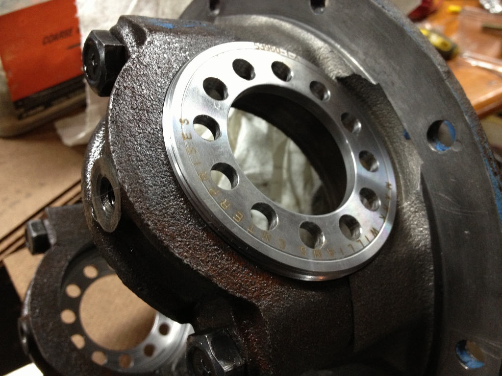

Just to prove that I'm actually working on it and not just harrassing Ted. Here's the gear set up, The Mark Williams adjusters are very nice. :hungry

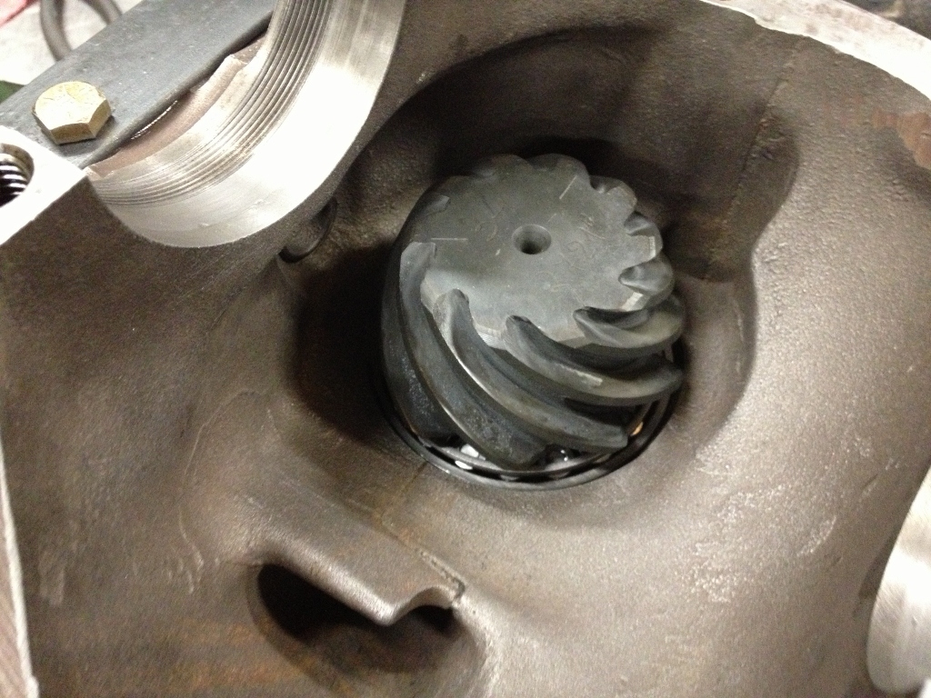

PostPosted: Tue Apr 02, 2013 7:29 pm
The adjusters
