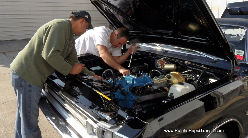

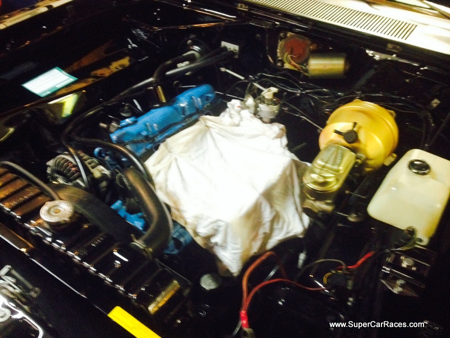

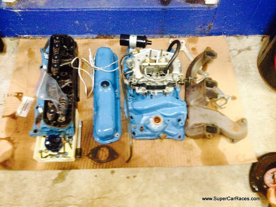

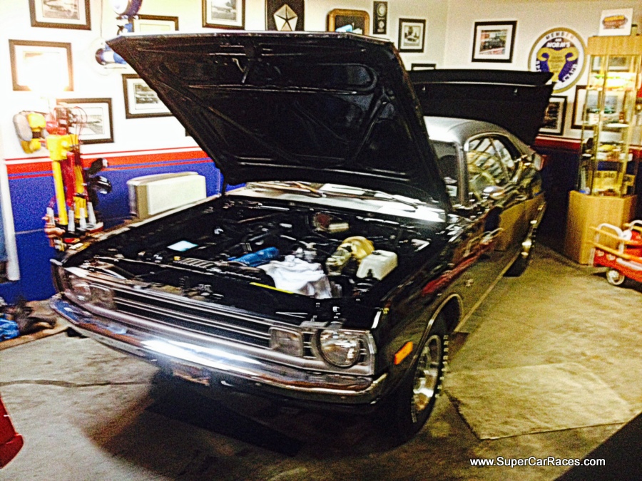

PostPosted: Mon Nov 12, 2012 10:38 am

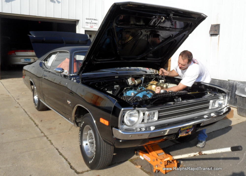

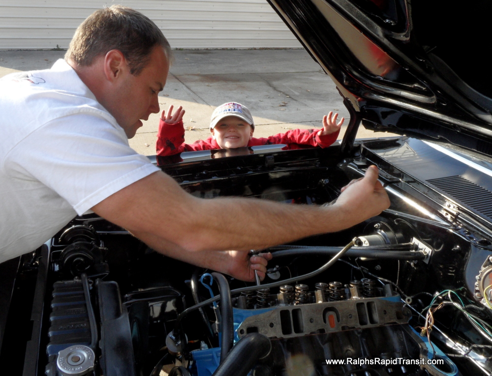

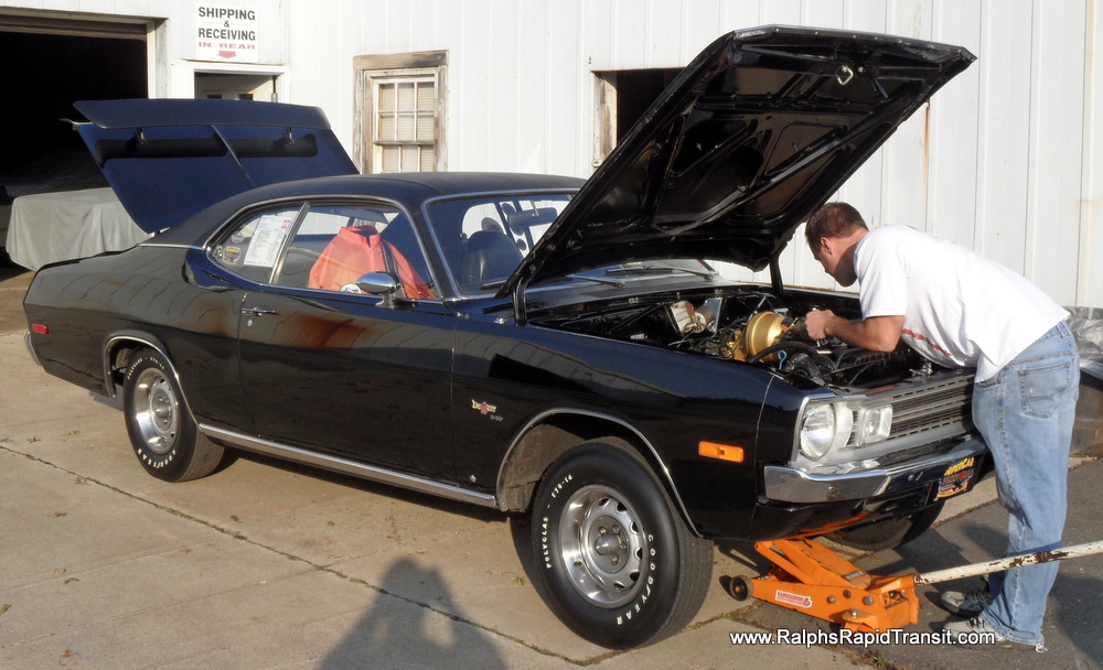

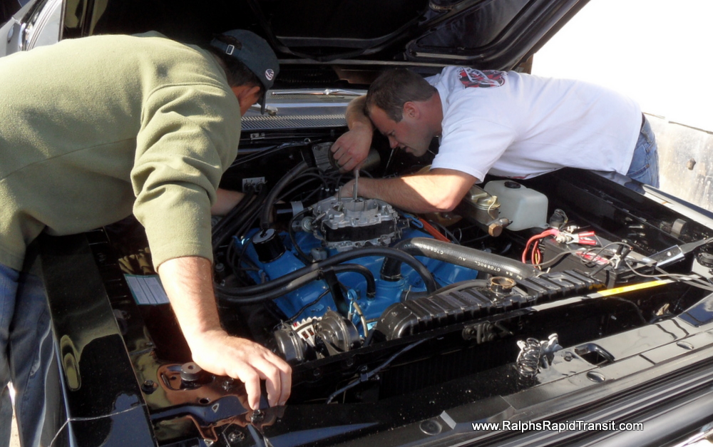

Re-assembly

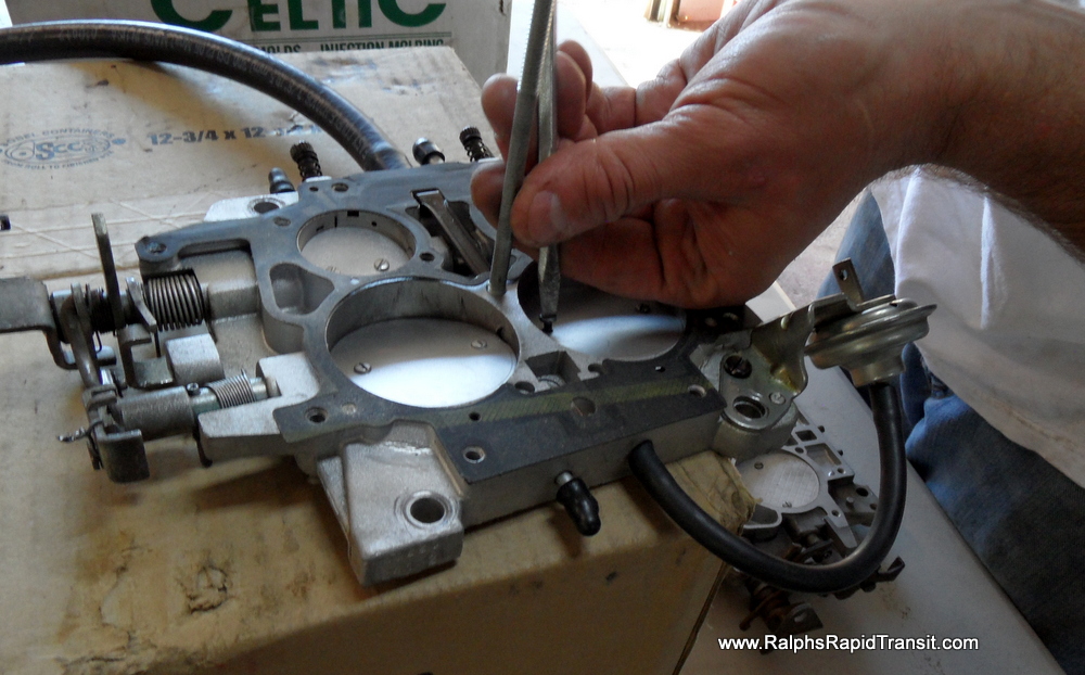

PostPosted: Mon Nov 12, 2012 10:40 am

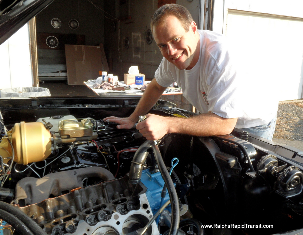

PostPosted: Mon Nov 12, 2012 10:41 am

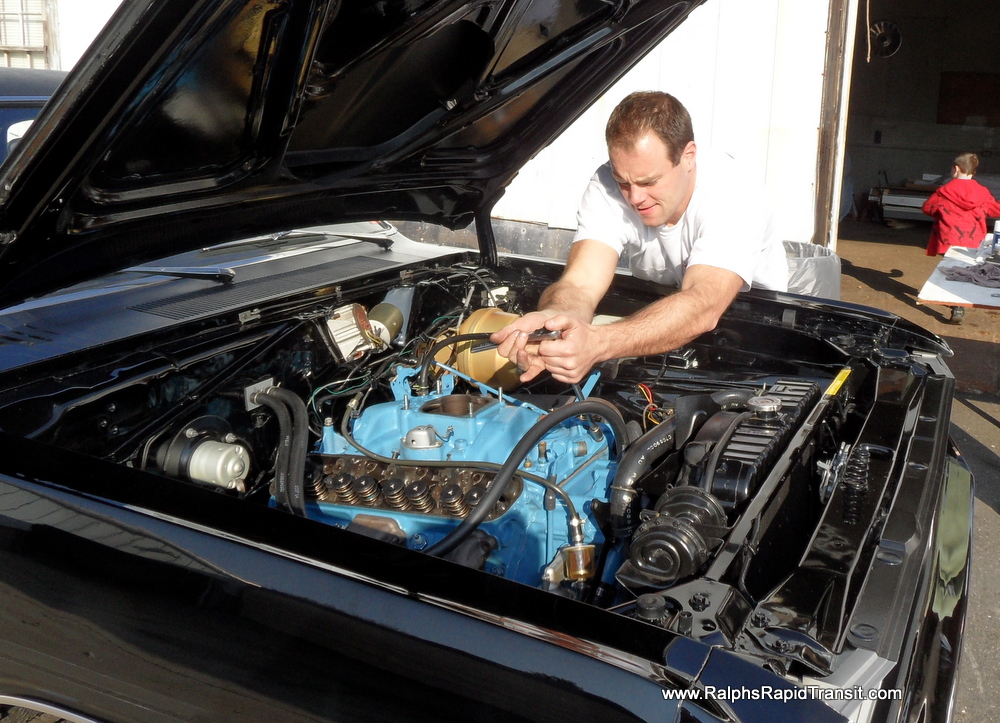

PostPosted: Mon Nov 12, 2012 10:43 am
:shrug
PostPosted: Tue Nov 13, 2012 7:28 pm
The Demon is ready to go scream-on down Atco's 1320 this Saturday. Valves are lashed and the body is waxed. See everyone this Saturday at Atco, NJ for what may be the last race of the 2012 season.
PostPosted: Tue Nov 13, 2012 8:23 pm

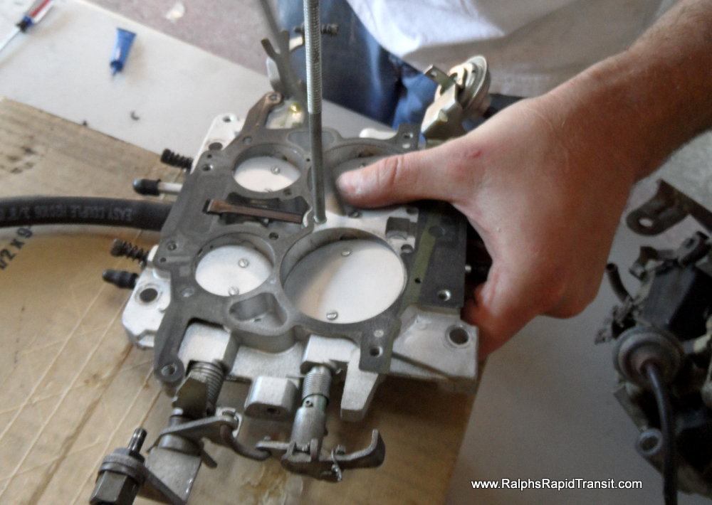

are you changing out the secondary throttle shaft? :pop are the new gaskets cometic?
PostPosted: Wed Nov 14, 2012 12:57 am
No just putting the new butterfly screws in, to replace the ones that were missing :sick .
PostPosted: Wed Nov 14, 2012 12:59 am
SCE Copper "The Best"

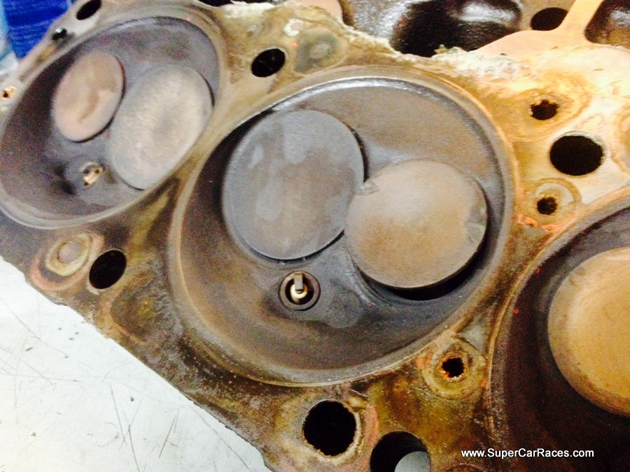

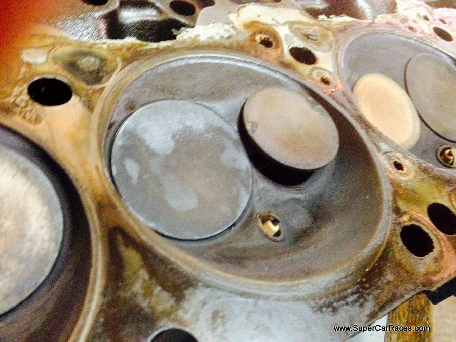

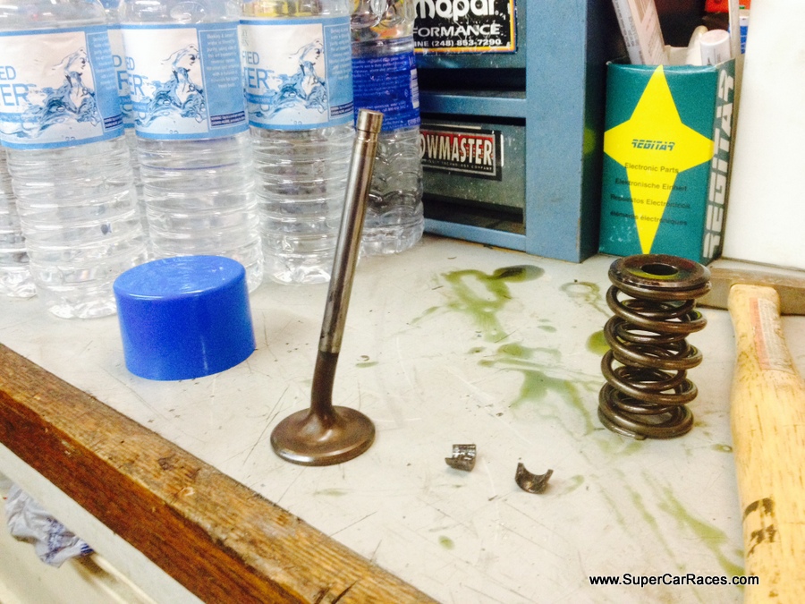

PostPosted: Sat Apr 25, 2015 8:30 am
Had time last night to take apart the 340 in the Demon. Damage was limited to a bent valve due to valve spring float. Valve springs used were not rated for 7000 plus RPMS. Easy fix should be back together for next weekend. Note to driver Demon makes enough power at 5800 RPM's no need to go above 6000. :aok
