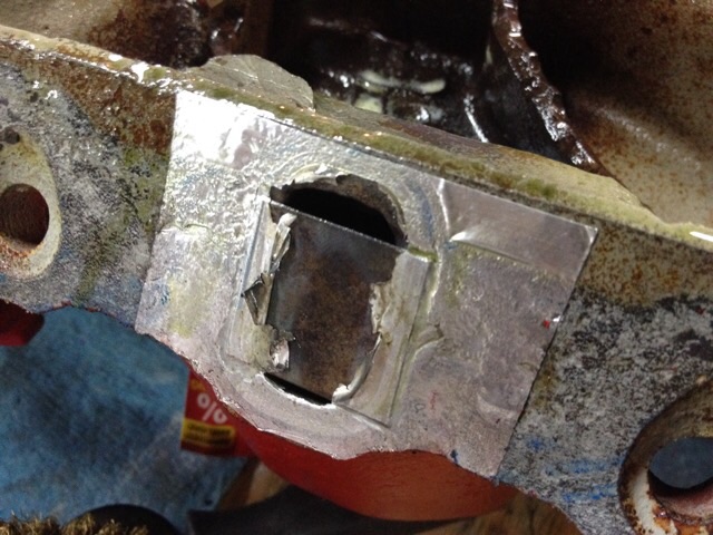

So I go out and adjust the valves and start the car. It starts to make noise, sounds like an exhaust leak,but can't find it with my stethoscope! Find out it is much louder near the opening for the oil fill. Pull the plugs and they look fine. Bore scope each cylinder no obvious issues. Check the lash, no issues. Run compression test 130 all cylinders. Spin it over with the plugs out no noises. Run it again. Noise getting LOUD! Something going downhill fast. Run it with valve covers off. Very loud! Then start thinking, wait a minute the intake manifold gaskets you used had the cross over passage in them, with the bottom of the intake mill off....... But I made little plates to support the old gaskets.....doh!!!!!!!!

PostPosted: Fri Apr 14, 2017 2:39 pm

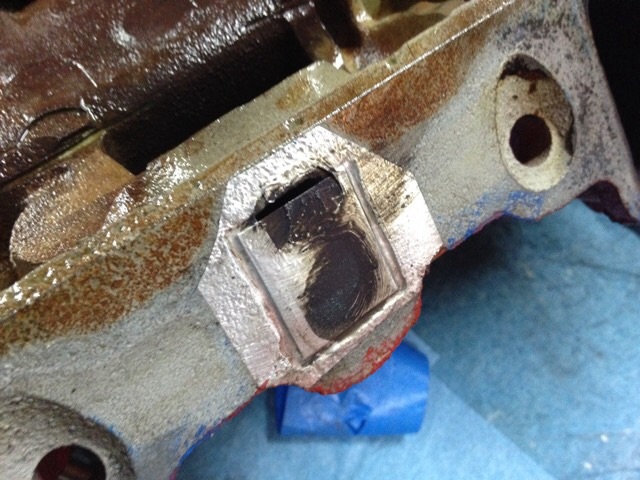

The other side!! Correct gaskets will be here sat am :bang

I guess the engine was never meant to be all nice new shiny paint!! :bang

Well definitely a problem but could of been a lot worse. Good catch there

Back together with two new red lines! Running fine with no noises. :pop
