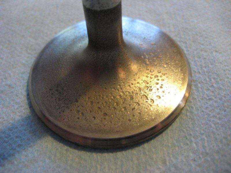

anyone ever see this before??
these are manley severe duty valves, #3 shown #1 almost has as many pits 5 and 7 very minor. "even" side no pits...cylinder 8 is the one that failed in the block...
dont forget this car had 5 gallons of gas, less than 2 miles on it(never left my driveway under power) never a pass never over 6000 rpm
speculation on another engine site is moisture on backside of HOT valve? It still had very close as much coolant in it when i took apart as when i filled it.
