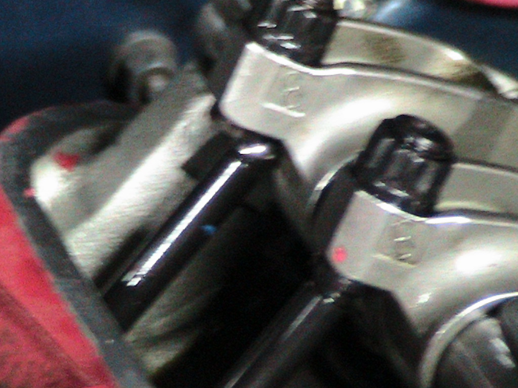

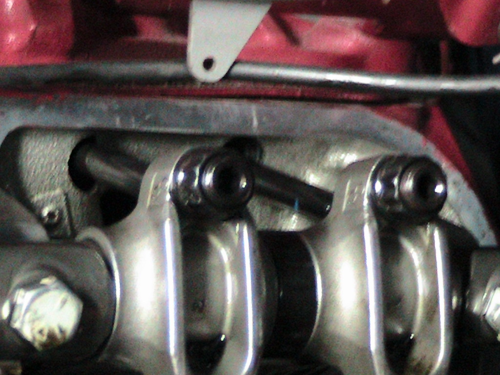

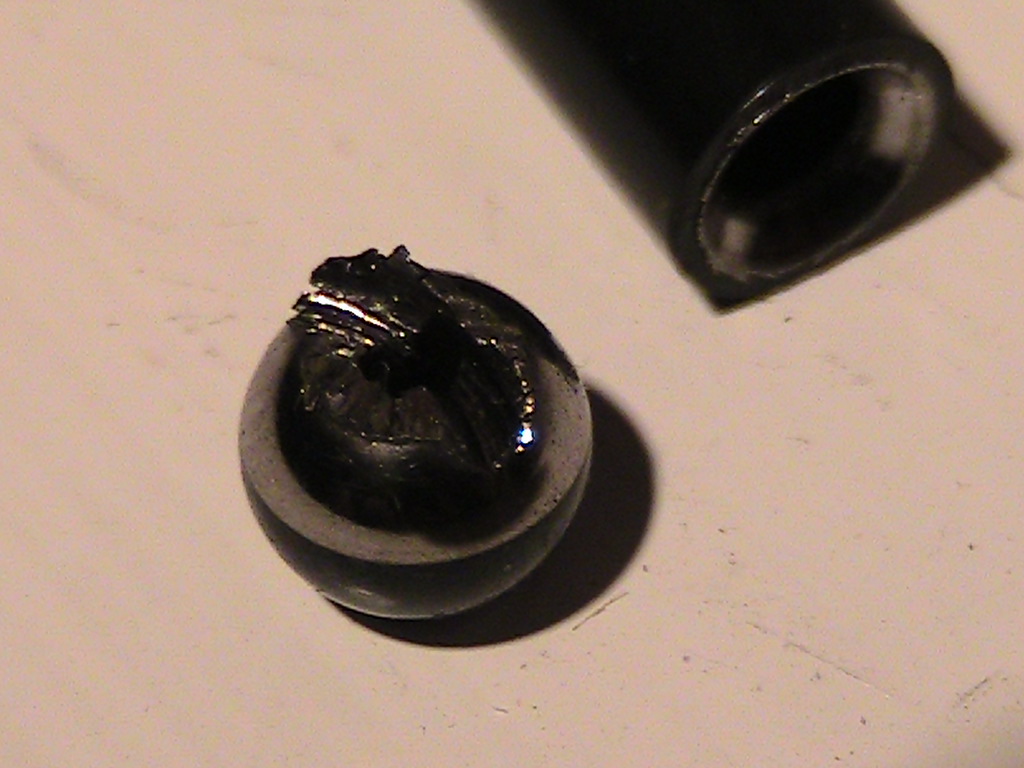

So I'm tuning on the car this morning I heading out to my test area. Just cruising through the the side streets and I hear a ticking almost a rap. oil pressure fine. temp fine, noise quickly getting bad, I swear I spun a bearing. Limp home the 1/4 mile. NOT happy. Pull the pan no trash in the oil and rods look fine, none loose,blue,ect. Pull valve covers and see Number 7 exhaust push rob has come out of the adjuster cup and is between the rocker body and the adjuster cup, Pull the intake manifold and nothing seems amiss. Cam lobes look similar to each other. Pull the rocker shaft and the ball on the end of the push rod dropped off. I'm going to pull the head to see if the valve hit the piston. The only thing I can think of is the lifter collapsed enough to drop the push rod out of the cup. I don't know. So if the valve didn't hit the piston I think the safest thing to do is replace cam,lifters,push rods and all the rocker adjusters.

Shouldn't have to pull the head. Can't see how you would get P-V contact by just having the ball broken off. Besides, there are other ways to check.
I don't think you "need" to swap the cam & lifters either, unless this is a good excuse to try a different grind. Adjusters aren't the most rock solid reliable things out there. Sometimes they break.
Just make sure to get a good set of adjusters, replace the pushrod if needed and button it back up.
But if you do put a new cam in, I agree with the guy above. :agree
PostPosted: Mon Jun 07, 2010 10:44 am
The cam looks fine as does the lifter for that valve. The only thing that concerns me is that because the push rod move towards the rocker center line and the ball was attached until I took the rocker shaft off. It was wedged against the rocker. see picture. It that position with the same linear travel of the push rod would increase the lift. If I'm thinking straight.
PostPosted: Mon Jun 07, 2010 11:28 am
Where was the broken ball? Pinned between the rocker and end of the pushrod? If it was missing then you lost peak lift by X amount. If it was pinned while it was running, go buy a lotto ticket. :wink:
I would think the pushrod would have gave if the valve hit. Either way, I'd either throw a straightedge across all the valve tips and or get ahold of a leakdown tester and check that way.
