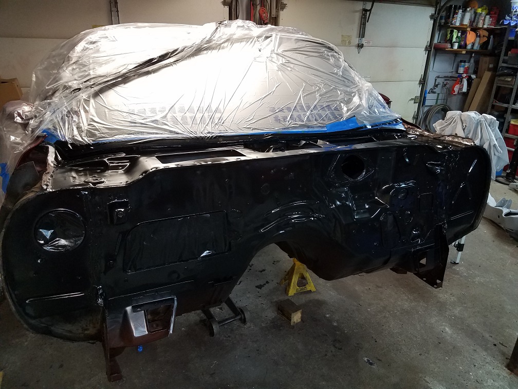

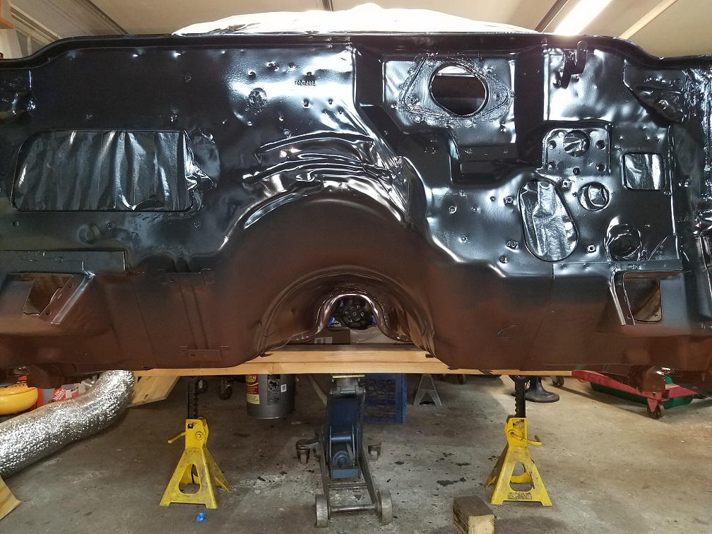

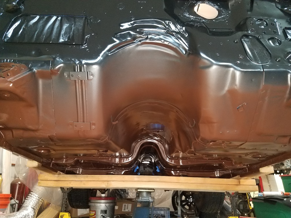

I reached a good turning point last night. The previous owner cleaned and sprayed from the rear seats to the rear bumper with a Rustoleum "espresso" semi gloss brown which looked very close to the factory color I unearthed after removing undercoat. So I ended up finishing the job all the way to the firewall. It was a tedious and messy job but done now.
Last night in my custom 8x8 pop up spray booth, I sprayed the cowl firewall with a coat of black epoxy prime followed by Deere Blitz Black semi-gloss trying to mimic the extent of the overspray based on what I saw after cleaning all the underocoat/gunk off. Of course the original black color was dead flat and this seems to have a little too much of a sheen but perhaps with more cure time and handling it will knock down some.

With that done I am off to work on the subframe. After I had it blasted the factory welds are appalling. Looks like a Friday afternoon subframe after throwing back a 6 pack of Stroh's, so I am going to buzz some of the more critical joints with my 220 mig. I also have to install some mounting pad reinforcements as the steel between the rubber bushings is a little corroded.
Slow going, but still going.

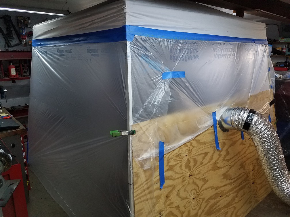

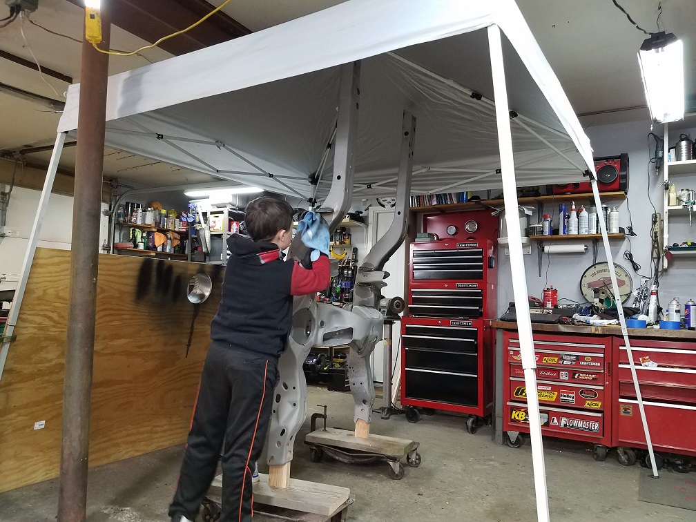

I wanted to shoot the subframe in one shot so I devised a way to stand it up on dolly's.
My kid wiping it down. The roof of the canopy just touched the top of the frame so it got a coat of overspray. :P
Spray booth all sealed off

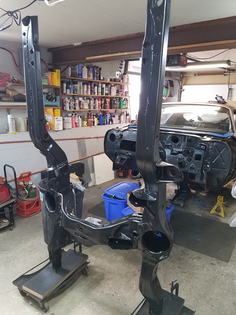

After 2 coats epoxy prime and John Deere blitz black. I used a cheapie harbor freight gravity feed touch up gun which worked better than i expected.
I need to let it cure a bit longer before I take it down so I can blast the inside of the rails with some POR.

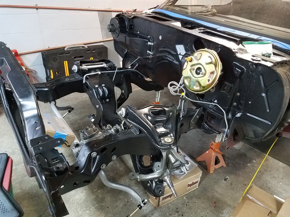

No field goal practice. The subframe is installed and aligned laterally and diagonally within 1/16" from the front leaf spring eye. I got a bunch of other parts bolted on. Next is reinstalling all the firewall/cowl stuff and then finish the suspension and brakes to get it back on its wheels. Its looking good just not going as fast as I expected. That's OK. I expect 2 kids in spring ball and the impending boating season will also hamper progress. But I'll just keep chipping away. I still haven't dropped the engine off to the machine shop yet. At this rate I'd be happy if I can take it on a fall foliage cruise with the family that it couldn't make last year because of a rod bearing.
