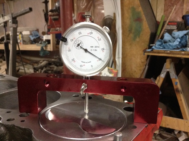

PostPosted: Sat Mar 04, 2017 9:28 pm
.010 in the hole

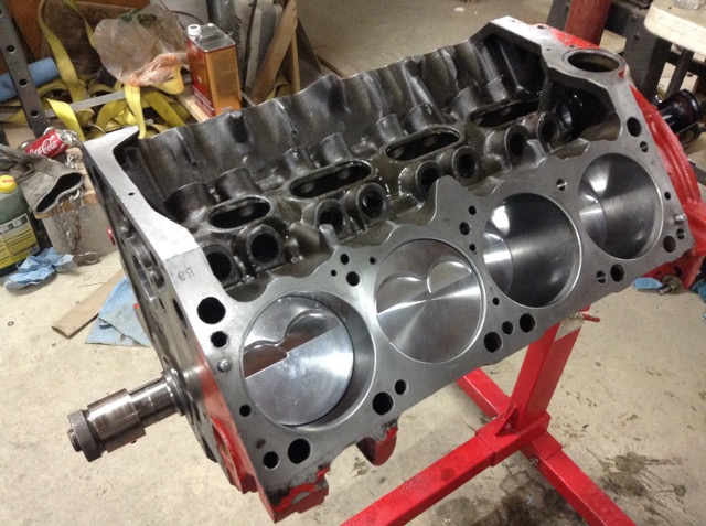

PostPosted: Sat Mar 04, 2017 9:35 pm
4.04 bore
4" stroke
63cc chamber volume
.010 deck clearance
+5cc piston volume
.027 gasket
12.09 to 1
410 CI
SMURF KILLER!!!!!!!!!!

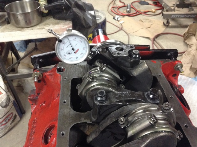

PostPosted: Wed Mar 08, 2017 1:09 pm
Degreed the cam and installed the heads. The passeger head wasn't sitting down nice and flat. So i took it off before tighten it down. Pulled the new cometic gasket off to see if the dowels were bottoming out with the thinner head gasket. Nope, but the rivet holding the head gasket together was getting pinched between the head and a protudion from the block meet. Right below the center exhaust ports. Drilled out the rivet and all is fine. Could have created havoc! Becareful with cometic and the rivers!

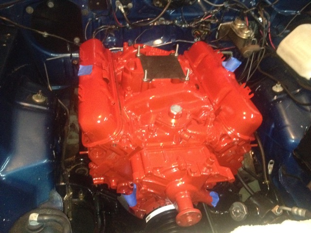

PostPosted: Wed Mar 15, 2017 8:43 pm
Painted

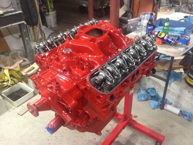

PostPosted: Wed Mar 15, 2017 8:46 pm
It's in!!!

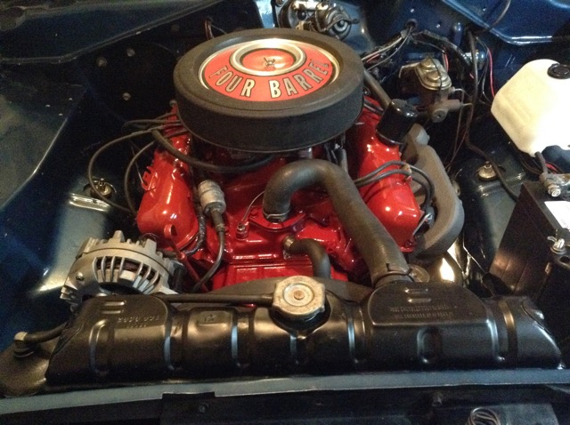

PostPosted: Thu Mar 16, 2017 12:43 pm
Looking almost show ready :pop
PostPosted: Sun Mar 19, 2017 3:33 pm
It's alive!!!!!! 37lbs oil pressure at idle, runs cool like it did before bouncing of the thermostat. The only issue was when I was priming the engine I had a 1/4 drive extension and a Allen socket to drive the oil pump. I didn't want the socket to come off the ext WAY DOWN THERE! So I welded it to the ext. prime the engine oil up to both heads. Pull the ext out of the distributor hole.........and the socket was still on the end........ The hex portion wasn't though!!!!! ARRRRRGGGGG! :bang :bang :bang :runaway :runaway it was still in the pump drive. After thinking about it I crushed the end where it was supposed to stay attached to. Put it back in and lightly tapped it back on the hex. Pulled it out and Ta da out it came! :pop
