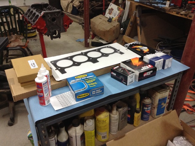

Parts!!!!!!!! and tools!!!!!

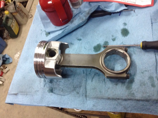

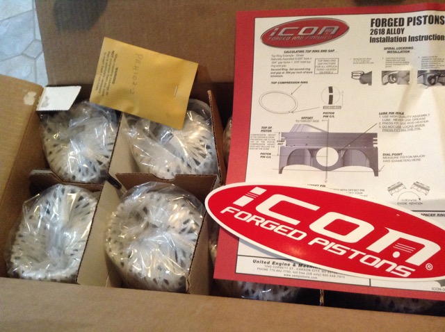

New flat top forged Pistons. Dropping it all off for balancing frid.

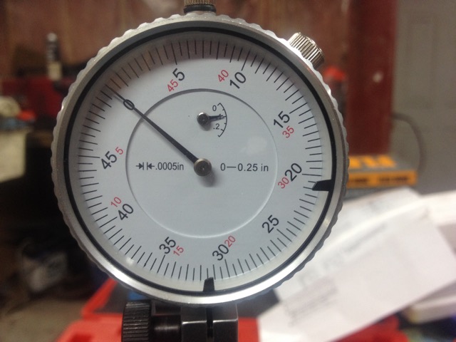

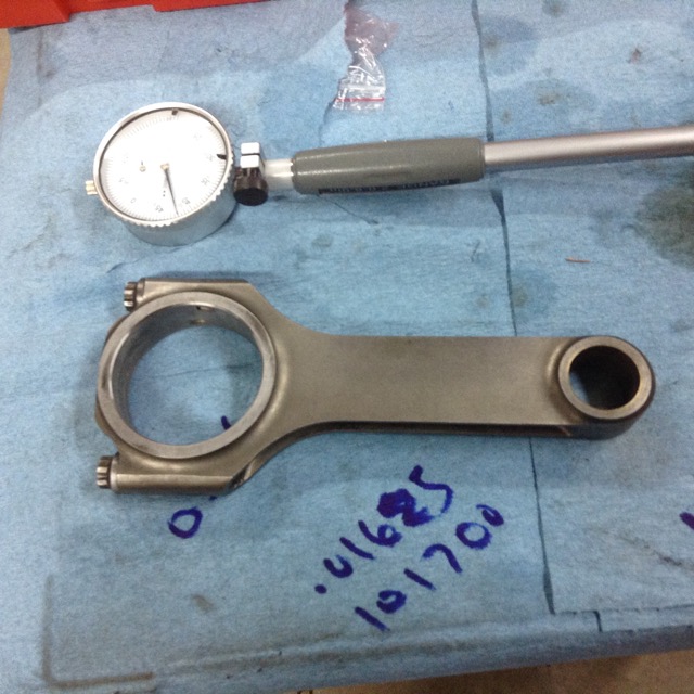

Checked the big end of the rods, still spot on.

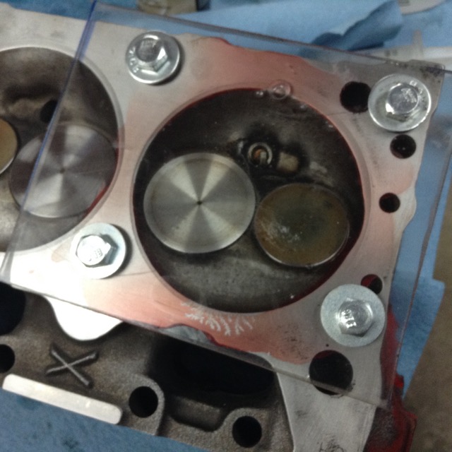

Cc'd the combustion chamber right at 63 cc's

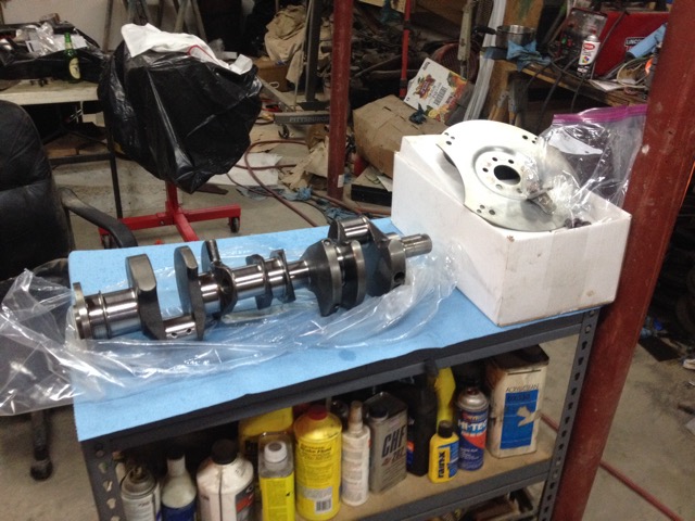

Dropped the crank off last Monday. Still straight,but it would probably not clean up with just polish. So cutting it .010 :pop
PostPosted: Sat Mar 04, 2017 9:14 pm
Picked up the crank it is spot on.

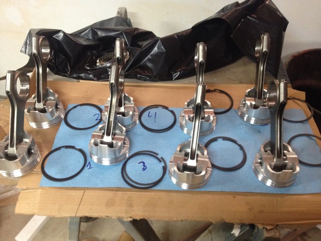

Spirolox are fun!!!!! :bang :bang
