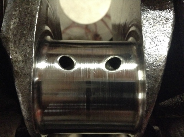

Ralph I would like to be able to say "After I took it apart I was kicking myself because it look so good!" Number 3 main :pop now that is a 3/4 groove bearing. The crank looks perfect!

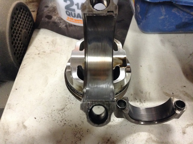

PostPosted: Sun Dec 18, 2016 3:28 pm
That's not even the scary picture! This is a rod bearing!

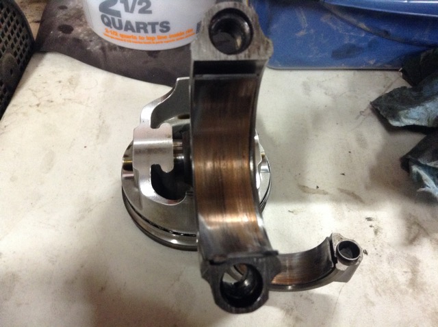

PostPosted: Sun Dec 18, 2016 3:31 pm
The others show less wear.

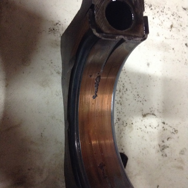

PostPosted: Sun Dec 18, 2016 3:33 pm
Crank looks fine. :pop

PostPosted: Sun Dec 18, 2016 6:04 pm
60lbs at the stripe and 27-30 at idle. :pop 55,000 miles and 700 runs since 2008.
PostPosted: Sun Dec 18, 2016 6:09 pm
The mains truly are 3/4 groove and no signs of heat at all. :pop
PostPosted: Mon Dec 19, 2016 12:40 am
Something introduced itself at one time and did its damage. Other than a set of bearings life should be good to go.

Yes, new flat top pistons/rings which are 10 grams lighter. Also going to have the rotating assembly balanced. Not sure how well it was bal before. Also timing chain set and the cam bearings need replacing. :pop u

I think the pitts in the bearing are from the water when it popped a head gasket. Water cavitation can erode metal. Seen it on boat propellers

It was align honed when Blueprint Engines originally built it. This short block is an interim short block. It's .040 over and cast Scat crank. When I go for the throat I'll use the other block. I'm sure the balancer failing wasn't very nice to the bearings.plus it's almost as old as the burnt orange RR! :pop
