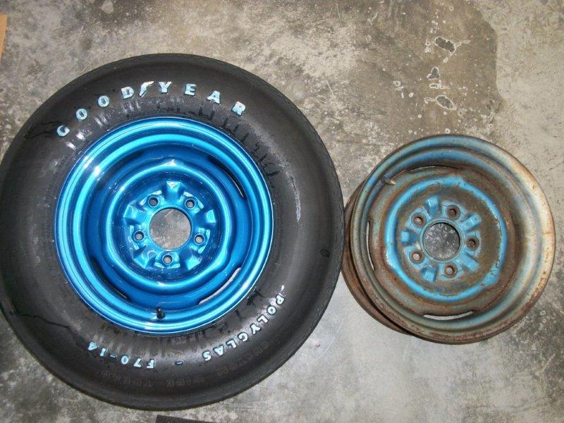

Billy,
I went with Wheel Vintiques type 62's from Summit. I think they were like $70 a piece if your going with steelies. If your looking for the real deals look for the XT or IF coded factory wheels. Here is a pic of the WV 62s next to an original XT. The height of the four "air gaps" from the center to the outer rim is about 1/8" shorter on the 62 vs. the original XT

cant go wrong with the wheel vintuques. wish i did that. i bought used IF wheels(9). By the time you blast and prep doesnt make sense.I know all this stuff ahead of time and i still buy the wrong crap.
plus the W.V are a littel lighter
