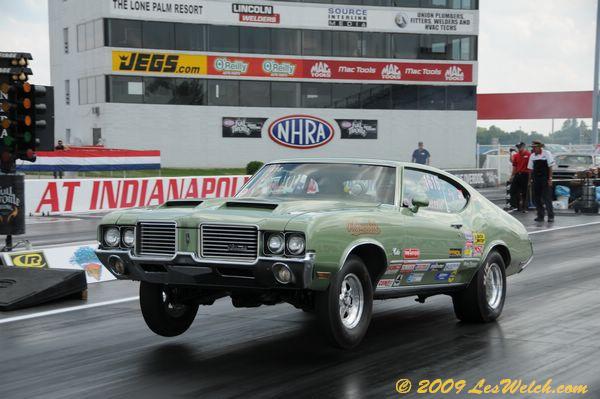

I have a pic of Wayne's NHRA record holder Oldsmobile
