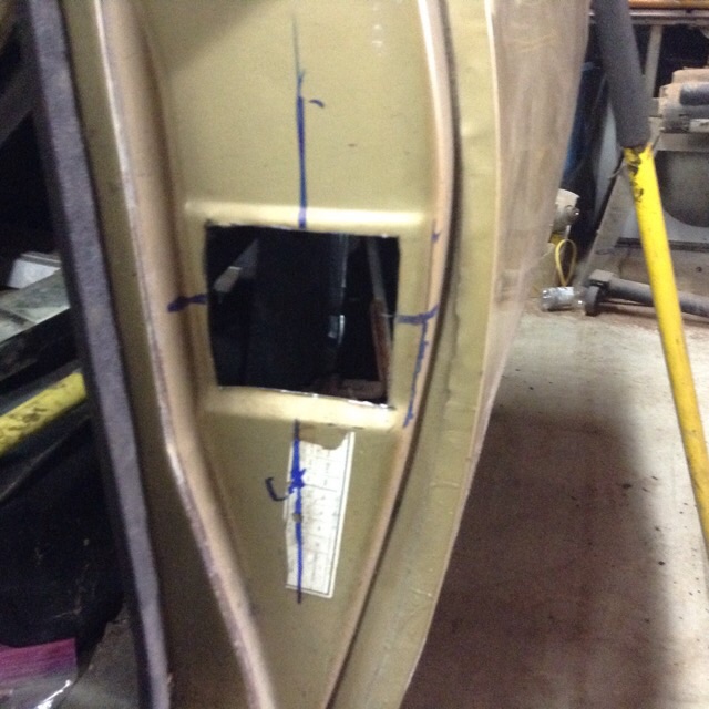

Dent repair!!

After a million studs!!!

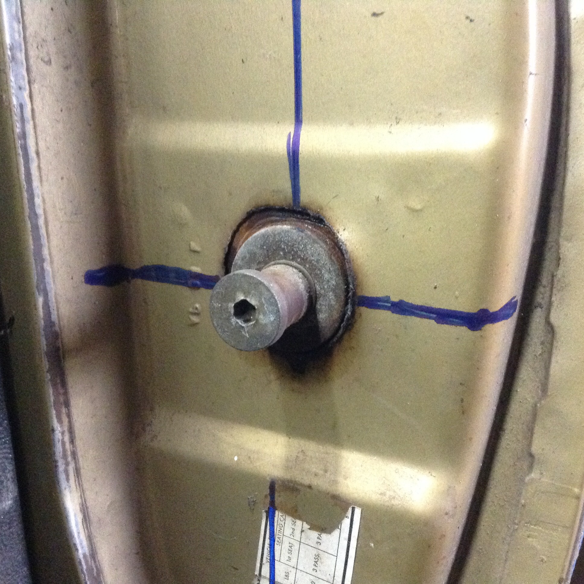

Typical a body door striker

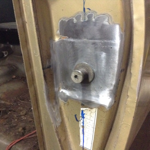

The thin jamb tears out around the washer. The repair doubles the sheet metal.

Stronger than new

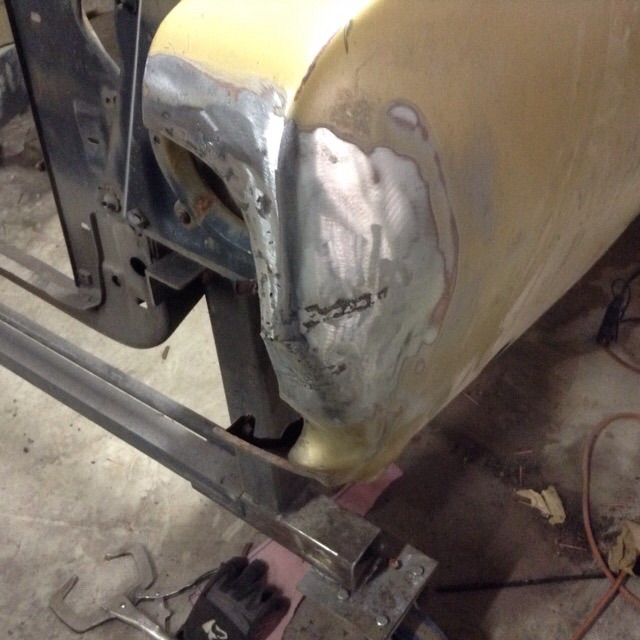

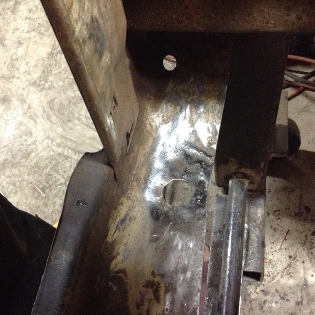

So someone in the gold fishes past thought it was a good idea to tow it by pulling on the bottom of the core support! :bang both sides are pulled and stretched 180 dregs and one hole was torn. :pop

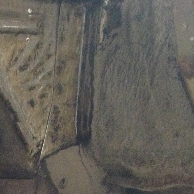

I forgot the joy of undercoat removal!!!! :runaway
