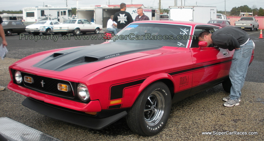

During the running or the 2010 SuperCar Fall Finale, one of our racers, Lane Carey, wanted to undergo a very thorough tech inspection and have the results posted online to dispel some rumors that he had heard concerning the legality of the car. In regard to the legality of his Intake, Wheelbase and a few of other items, he asked that we look over every inch of his newly built 1971 Mustang Mach 1 and document the tech inspection.

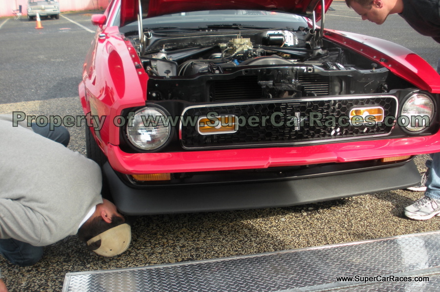

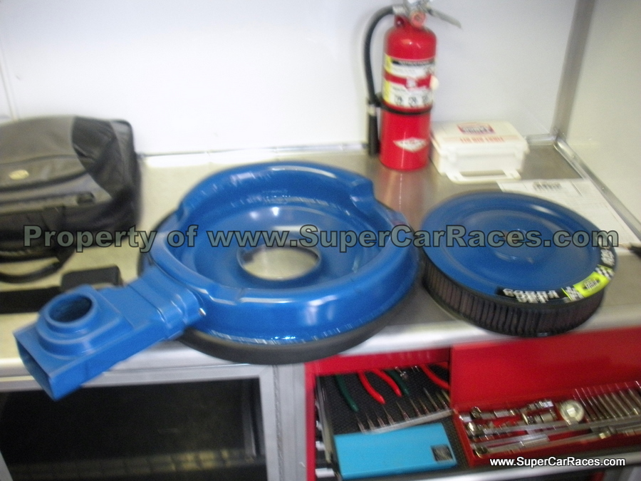

PostPosted: Fri Jan 22, 2010 6:21 pm

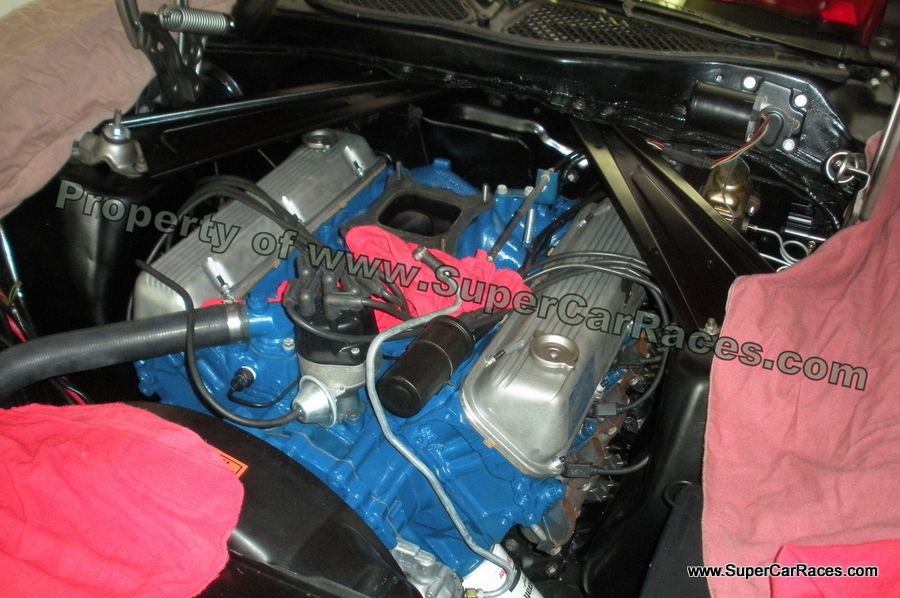

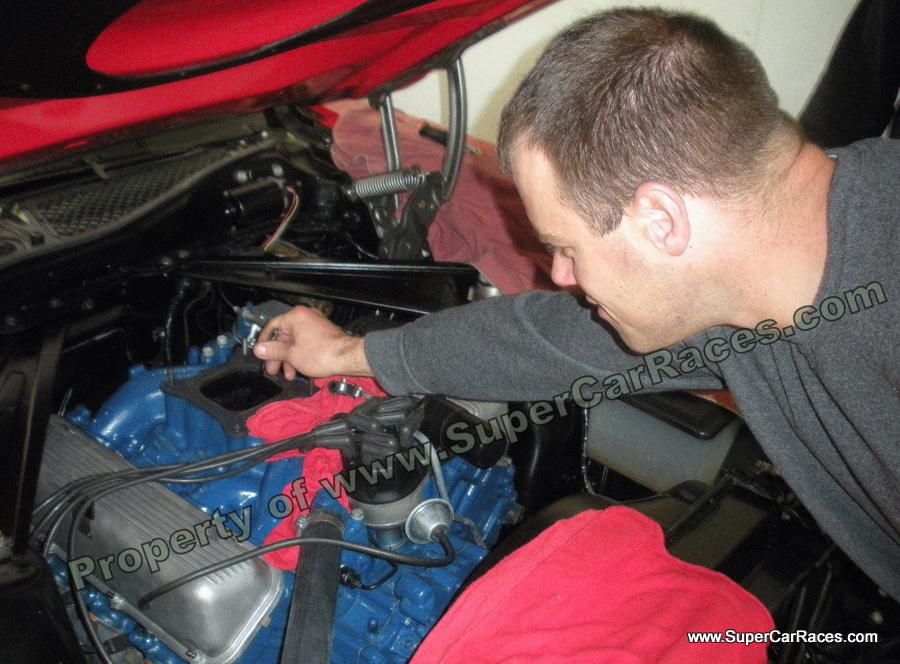

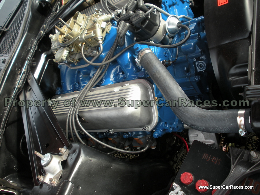

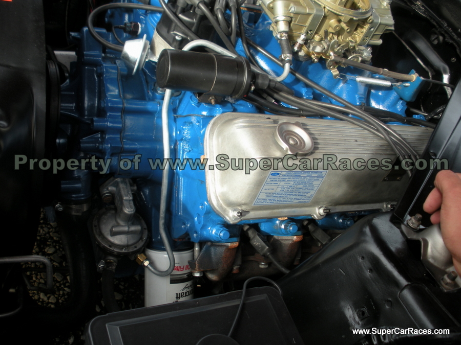

Tech inspection on Lane's Mustang started in the engine bay with the air cleaner removed. There was a complete inspection of all casting numbers, including, but not limited to, intake manifold**, head casting number, exhaust manifolds. Block legality was confirmed and consistent with current SuperCar Rules. Lane removed the carb as instructed by the SuperCar Rules Officials and the correct intake material, construction and model intake were checked. The correct appearing carburetor is being used on the Mustang. The rule infraction found in the engine bay was a non-factory appearing passenger side valve cover. The valve cover had been altered to accommodate an aftermarket vacuum pump hose.

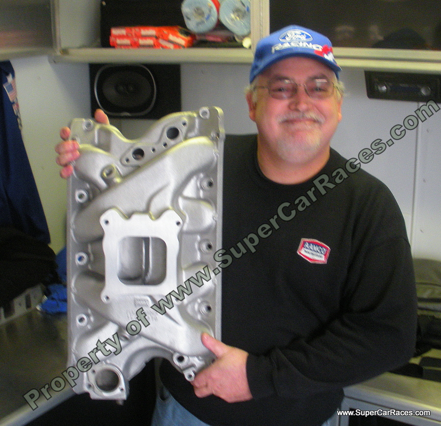

 Post subject: Lane Carey's 1971 Mach 1 SuperCar Certification
PostPosted: Fri Jan 22, 2010 6:23 pm
**Lane pulled out an aluminum intake manifold, unlike the cast iron intake running on his Mach 1, and explained the rumor going around.

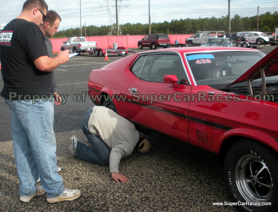

PostPosted: Fri Jan 22, 2010 6:26 pm

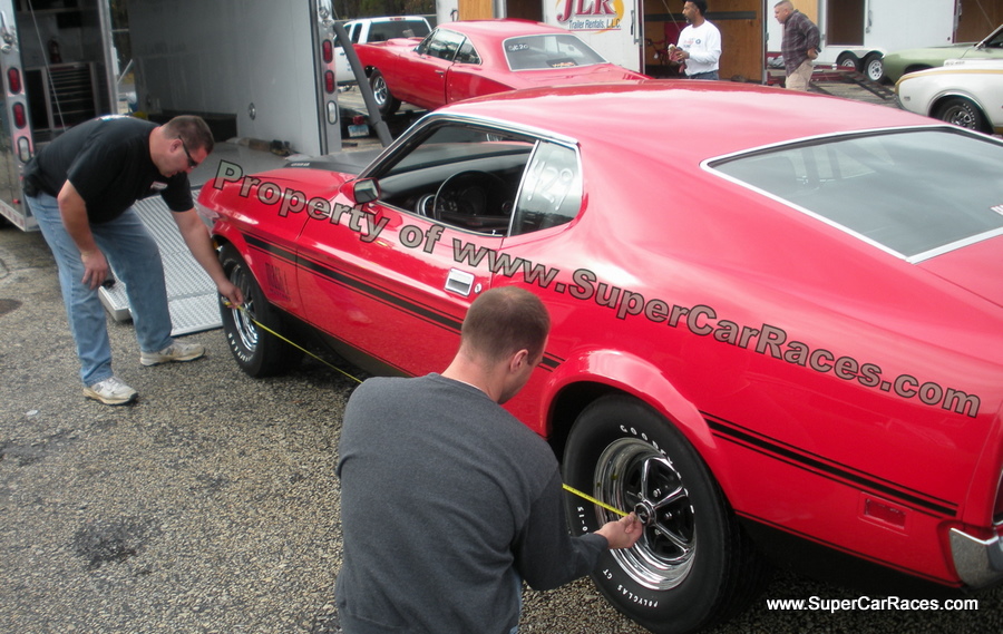

Next we checked wheelbase to confirm the Mustang was set to the correct factory wheelbase. Lane asked that we check that the axles location placement in the wheel well area was correct to dispel additional rumors that he moved the axle forward to help with weight distribution. All measurements were confirmed and no trickery was found.

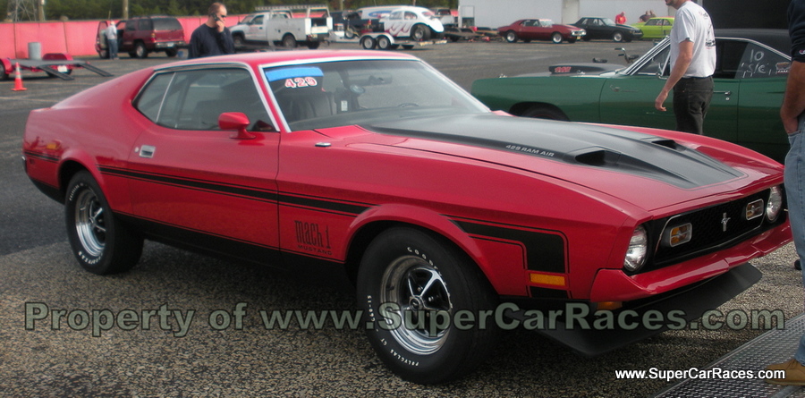

A complete look over of all body panels, bumpers and accessories. Rules infractions found: front head light brackets had been modified and would need to be replaced to be legal.

Final Rules findings and Certification results.
Lane Carey 1971 Mustang 429 SCJ Auto
Rules Infractions: Non factory Appearing Valve Cover (Passenger Side), Leaf Spring packs, Paint Tie Rods, Headlight Buckets Replaced.
5.01 Valve covers must appear correct.
13.16 Shocks and springs must appear correct.
Aftermarket adjustable shocks are OK if painted to appear correct. Composite or other lightweight material leaf springs are not allowed.
1.01 The correct original appearance must be retained
Certified; YES 10.96 E/T 128.18. MPH
