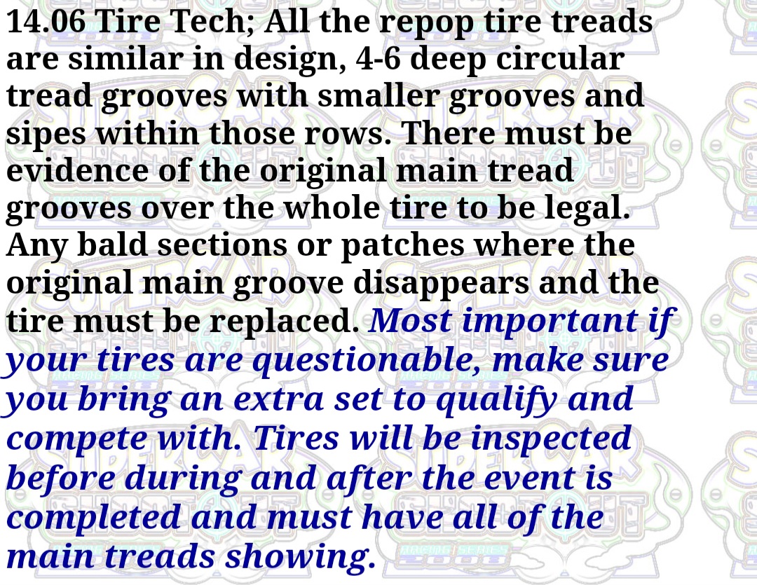

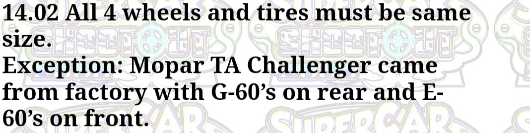

I've attached two of the Supercar rules. One clearly describes the tread pattern requirements for the reproduction tires that those of us with 60s and 70s musclecars are required to use. The other states that front and rear tires must be the same. Yes, there is an exception. The front tires on the Hellcats and Redeyes that I've seen, in my opinion, are within the regulation. The Goodyear Supercar F1s clearly violate both regulations. The tread pattern is more like a drag radial than a street tire. They also give an unfair advantage to one make and model. The solution is simple and fair. Require the Hellcats and Redeyes to use the same street tire front and rear. Treadwear cannot be the only criteria.

 Post subject: Re: Tire tread rating, tire size and all things tire related.
PostPosted: Mon Nov 06, 2023 7:44 pm
I'll break this down so that I'm able to answer most if not all the questions.
Yes our rule at the moment says all four tires must be the same. We can mandate that you must run 200 tread wear tires on all four corners. The issue is, at this time all of the newer SuperCars are driven to the track. With their 200 tread wear tires in the trunk and mounted on the car once they get to the track. To have four tires in the trunk could be an issue. To change four tires once you get to the track so that they all match may be excessive to do. We may need to revise this rule. Not sure what the exact wording would be at the moment. As these newer cars start to age most will then be trailered and at that point we can revise the rule if needed.
The Goodyear SuperCar F1's are legal to use. They are of the correct compound that we have approved for SuperCars. These tires are similar to the Nitto's, General's and other tires with the 200 tread wear.
We've tested many tire compounds when we changed our series to include all SuperCars from 1955 to Present. The Redeye and ZL1 are the quickest SuperCars ever produced from Detroit. *We feel as we have always said the tire is the equalizer in Factory Appearing Stock Tire Racing. The 200 tread wear radial tire keeps the racing close between the Vintage SuperCars and new SuperCars. This also gives the SuperCars of the late 70's thru early 2000's a radial tire that would make those SuperCars competitive.
*We at SuperCars do not allow bald tires of any type in our series. As many have witnessed, when you remove the tire from the equation the series suffers, not mention the safety aspect of braking down a tires side wall and grinding a tire to almost the cords is unsafe and not accepted or allowed at any NHRA or IHRA track.
I'll dig out data I have to show you how the treadwear we allow is the equalizer between the Polyglas and Radial tire.

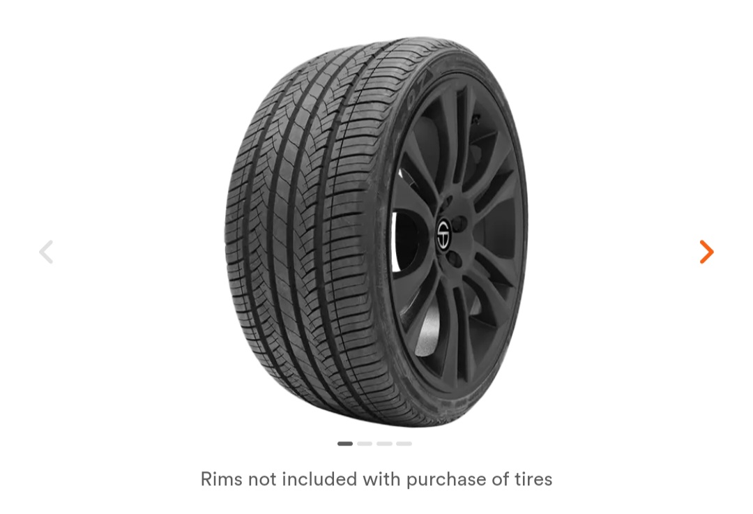

No one is suggesting that a pseudo drag radial Goodyear Supercar F1 be mounted on all four corners. That would be absurd! Mount a tire that looks like this all around and you can drive to the track, race all day AND comply with the rules! 200 Treadwear cannot be the only criteria. If classic musclecars must comply with a specific tread pattern, so must modern muscle. It's only fair.
