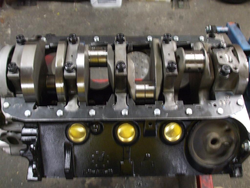

Not where I wanted to be at this point. After looking at the deck to check pop up I noticed that the pistons were tilted a little. Looking at the top, the "left" side was .010" talller than the right. Every single one was the same. Left higher than the right. I pulled number one and brought it to work to do some measuring. It appears that the pin holes in the rods are not parallel. Talked to the rod manufacturer and they want to see them and will correct any issues.
I've got to say if the piston was in the hole a little I probably would not have noticed and quite frankly it would have probably not made a difference. But this is not right to me and needs to be addressed.
The good news is once I get them back its just a matter of throwing it all back together. All the tedious stuff is done. Didn't have to touch the crank setup or the cam.

The rod company verified the bores were off a bit and they are being re-worked. Due to be back soon. I have a feeling that I will be going crazy not getting anything done and thing this motor will be done before long.

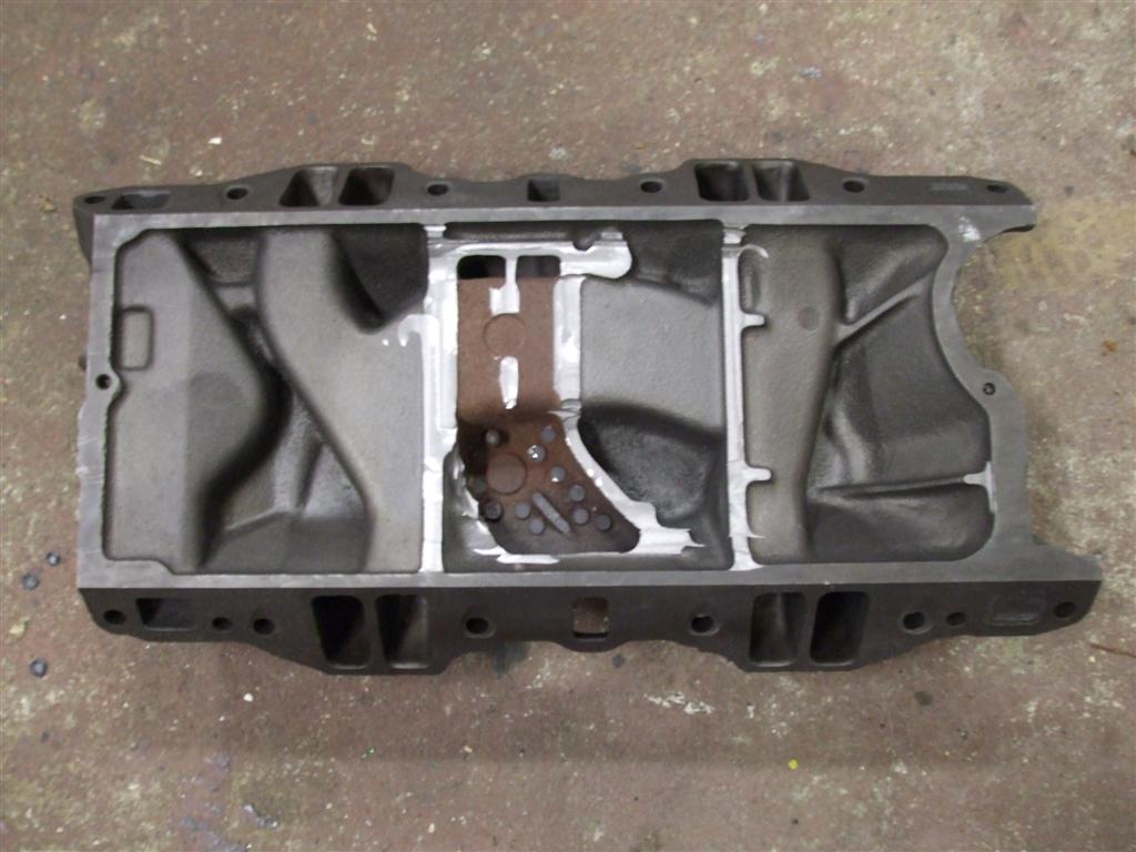

Yesterday I plopped the intake up on a Bridgeport and took a little unnecessary weight out of it. I will be bonding a steel plate underneath as sort of a valley tray to keep hot oil off the underside of the manifold.

Well I just got off the phone with K1 Technologies. Rods should be finishing up today and hopefully shipping today also. Either way they should be in by the weekend when hopefully Ralph will swing by and get a good chunk of assembly done.
All the clearancing and blueprinting is done. Its just a matter of putting the rotating assembly together.

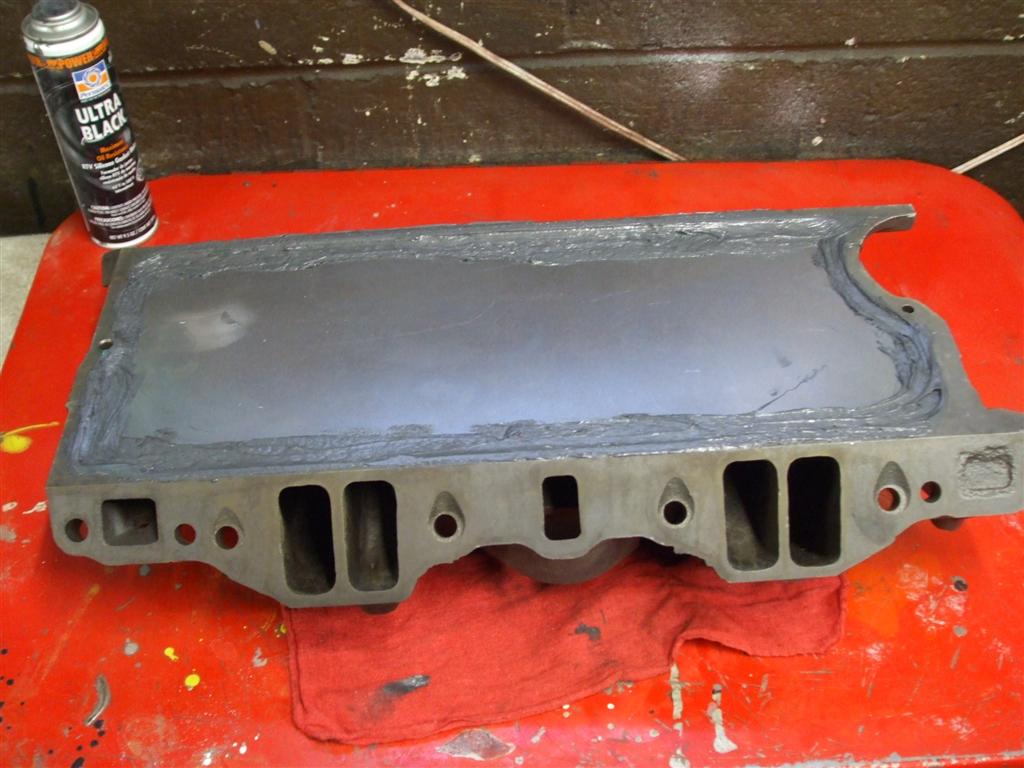

Heres the intake with the heat shield installed. Its simply a piece of sheet steel "glued" to the bottom of the intake with Right Stuff. The idea is to keep hot oil off of the iron intake.

Rods came in yesterday and a quick trip to work this AM to borrow the toolscope proved they are good to go.
Today I got a little cleanup in the garage to do to get back in action. Ralph is coming by tomorrow AM and we're going to put the screws to it.
