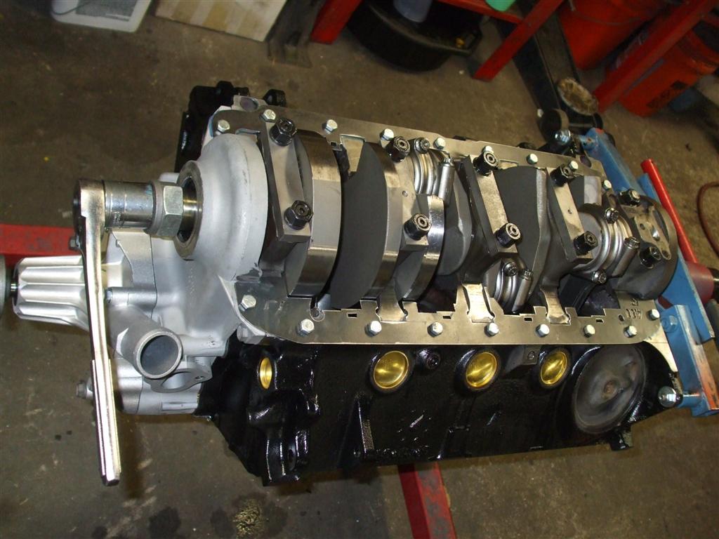

Had to make a call to get some offset cam keys to get the right installed number. It was 3 degrees too far advanced, now its spot on.

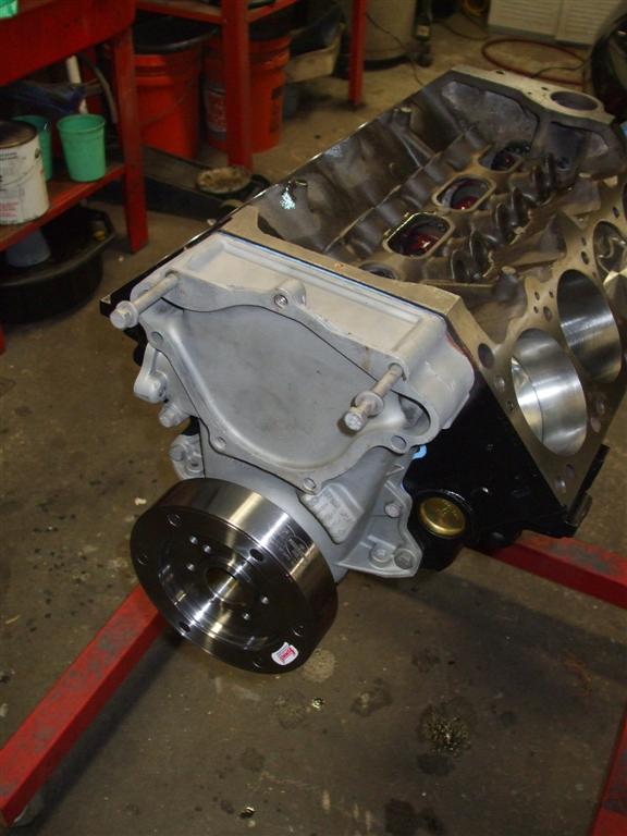

Thats a wrap! Timing cover installed. That balancer will get blasted to provide a little tooth for the Chrysler blue to stick to. Now its time to move onto scraper install..... Tomorrow.

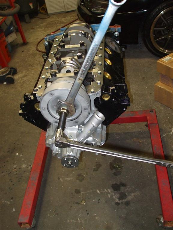

Balancer blasted and being installed. It pays to buy the right tools.

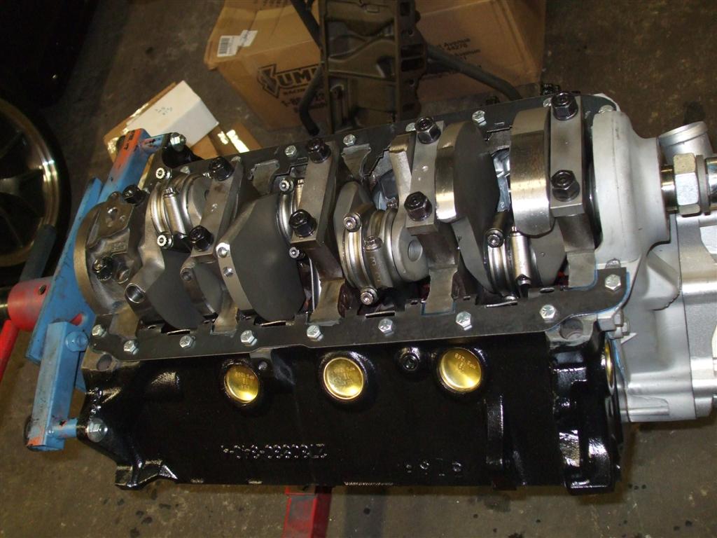

Crank scrapers have been fit and "glued" to the block with RTV. These take the place of the cork rail gaskets.

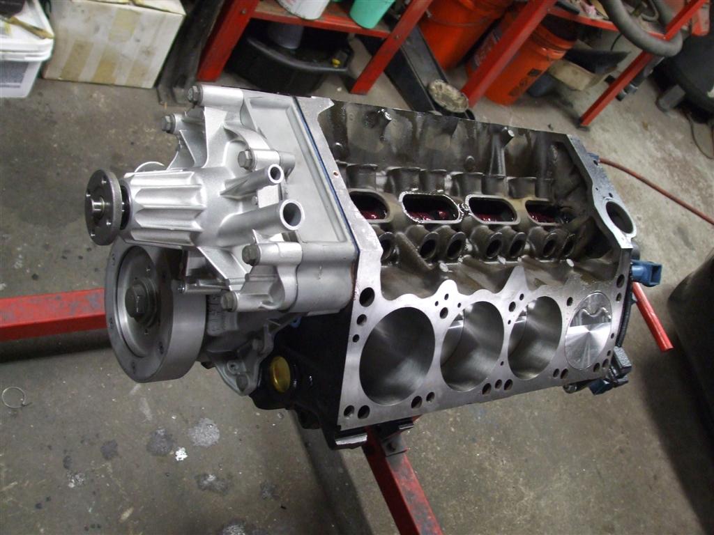

Starting to look like a motor! Pistons pop out .010". Resultant compression ratio will be 12.2:1.

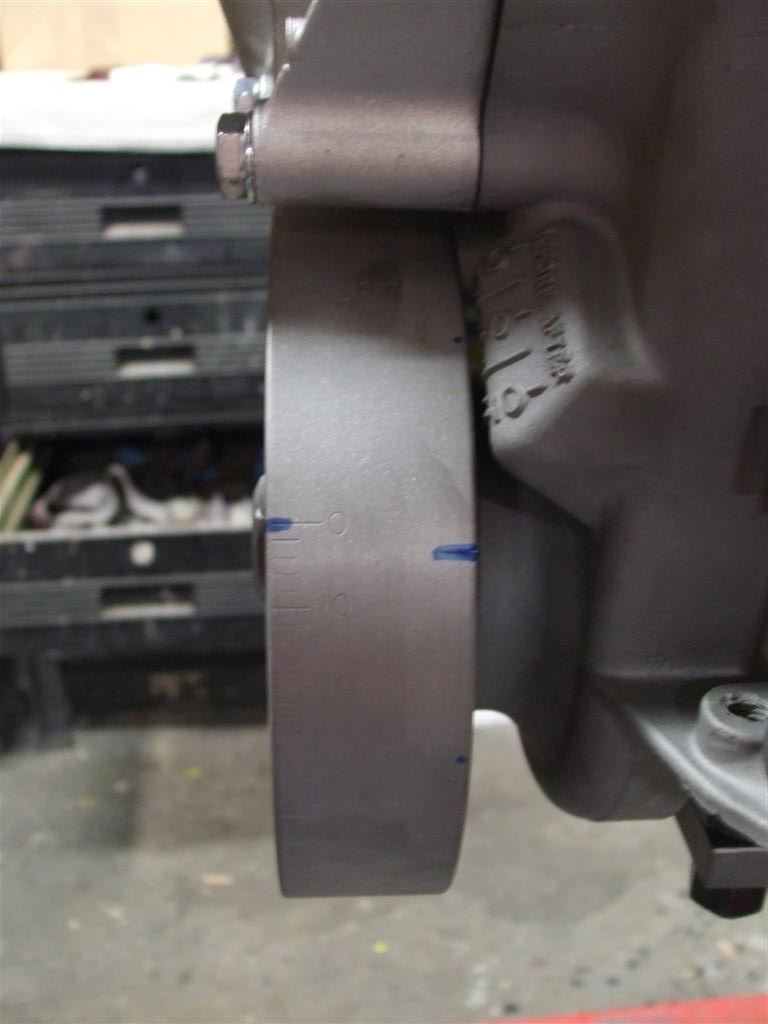

PostPosted: Tue Feb 23, 2010 11:40 pm
I wanted to double check the balancer timing mark with a piston stop. I don't even know why they engrave them zero is off so much. :shrug Let alone the marks on the front side. Just ship them with a timing tape and make people check. You can see the difference, about 2 degrees. We'll install timing tape using the new notch as 0 once its painted. Notice the nice pronounced marks on the timing cover. Wish my motor had them.

Chris, are most aftermarket balancers off that many degrees, or just the one in particular that you installed on this motor? Have you run into this problen before?

 Post subject: Re: Supercar Smallblock Build
PostPosted: Wed Feb 24, 2010 11:01 am
I'd suggest you check them all. You are checking lots of potential tolerance issues. The crank keyway to the crank throw, the key to the balancer hub, the marks on the outer ring of the balancer to the hub and the timing pointer location. It's a 15 minute procedure and ensures you are spot on.
