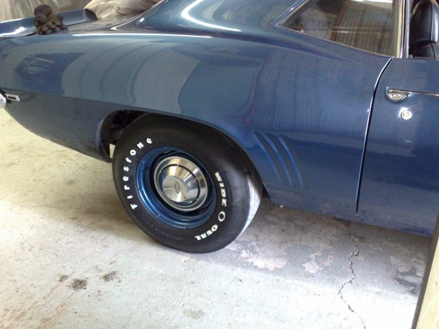

how many screws would be considered sufficient
 Post subject: Re: Safety Requirments
PostPosted: Mon Nov 29, 2010 9:02 pm
Screws? :shrug
PostPosted: Mon Nov 29, 2010 9:54 pm
Posts: 315
Screws? :shrug
I don't see any screws.
8 per side Ted.
PostPosted: Mon Nov 29, 2010 10:17 pm
is that Mr.V's car? :roll
PostPosted: Mon Nov 29, 2010 10:21 pm
Glue before you screw....
PostPosted: Mon Nov 29, 2010 10:45 pm
Posts: 315
No Mike, That's Eugene Patel's 69 COPO Camaro that I built for him.
