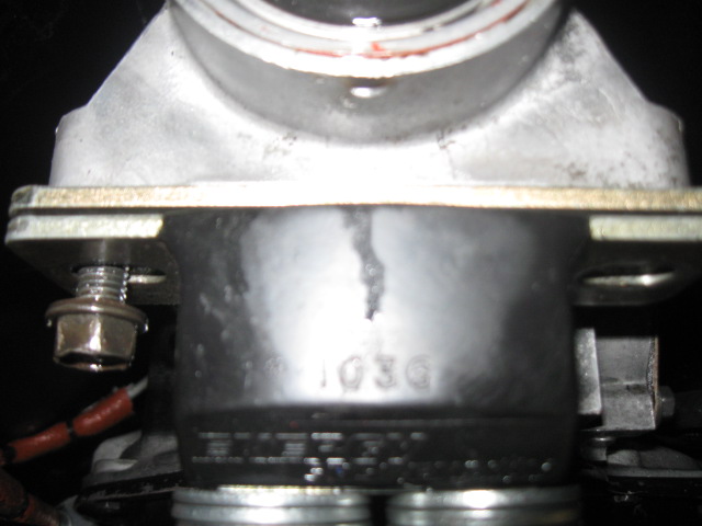

This is a pic. of my trans. mount after Atco.I always do a visual inspection after every race except i did not after Etown.It almost cost me big time.I put the engine in the day before Etown and forgot to tighten the 2 mount bolts and as you can see one is missing and the other one was hanging as you see it with 3 turns before it fell out. :shock:

:sick
Fortunatly you were running brand new tires, if that hooked forgetaboutit!!

Ouch, that was a close one ! on that trans mount..
