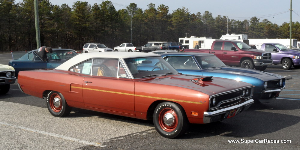

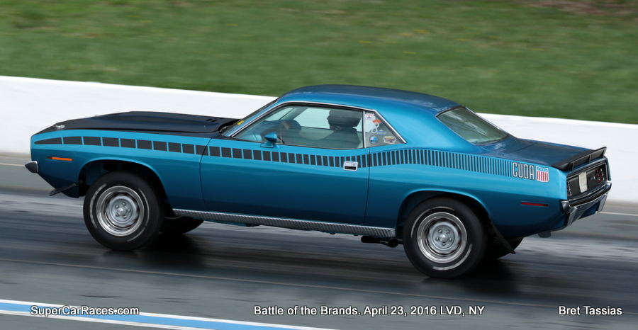

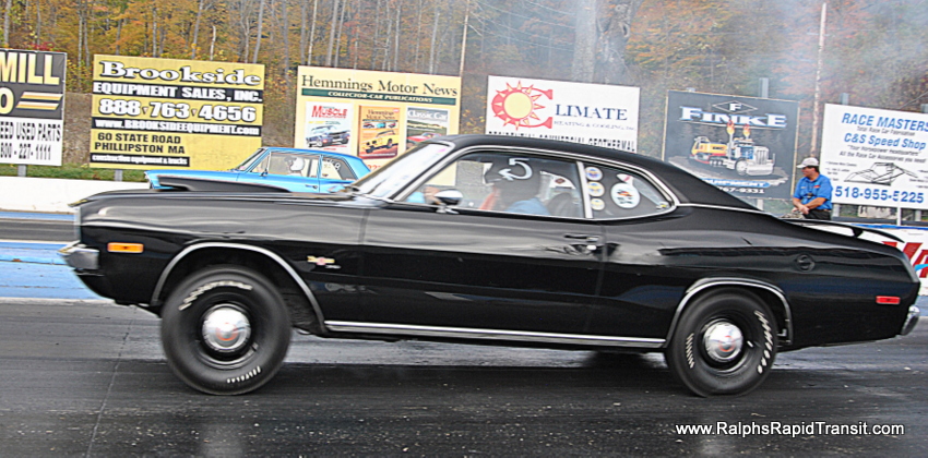

2021 3 SuperCars out the Ralphs Rapid Transit Stable.
Points Championship run will be made in the HP2 this season. Looking to run 14 Races with the HP2. Upgrades for 2021 in the HP2 is a new Mill. 578 Hemi 12 to 1, Cam Change to a more aggressive Cam profile.
Demon will be back for 2021. Limited Schedule. The 416 has not been changed. Changes made to the suspension.
AAR Cuda will also be back for 2021. Limited Schedule. New Transmission is the only upgrade for 2021. Plans are to pull the 444 at the end of the season and partner with Chris Kuskowski & Jeff Patterson to upgrade build.
Looking at 2022, Burnt Orange 1970 Road Runner is getting a new Mill, 500 inch 13.5 to 1 Hemi. Build is almost complete.

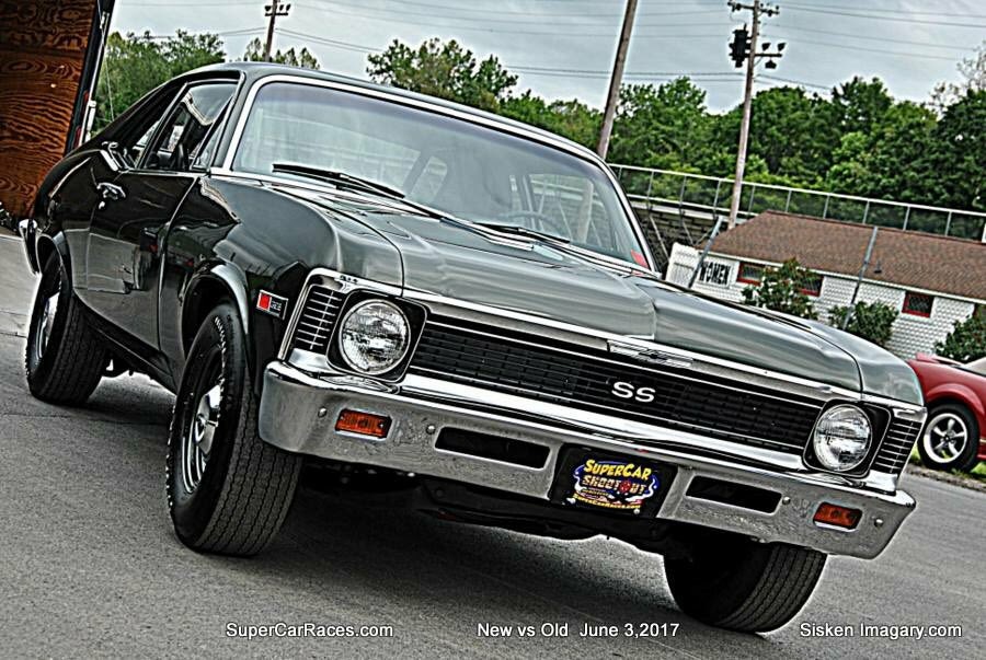

69 Nova Hemi killer

:bow :bow :bow :bow :winner :bow :bow :winner :bow :bow :bow :bow :bow :bow :pop
69 Nova Hemi killer
